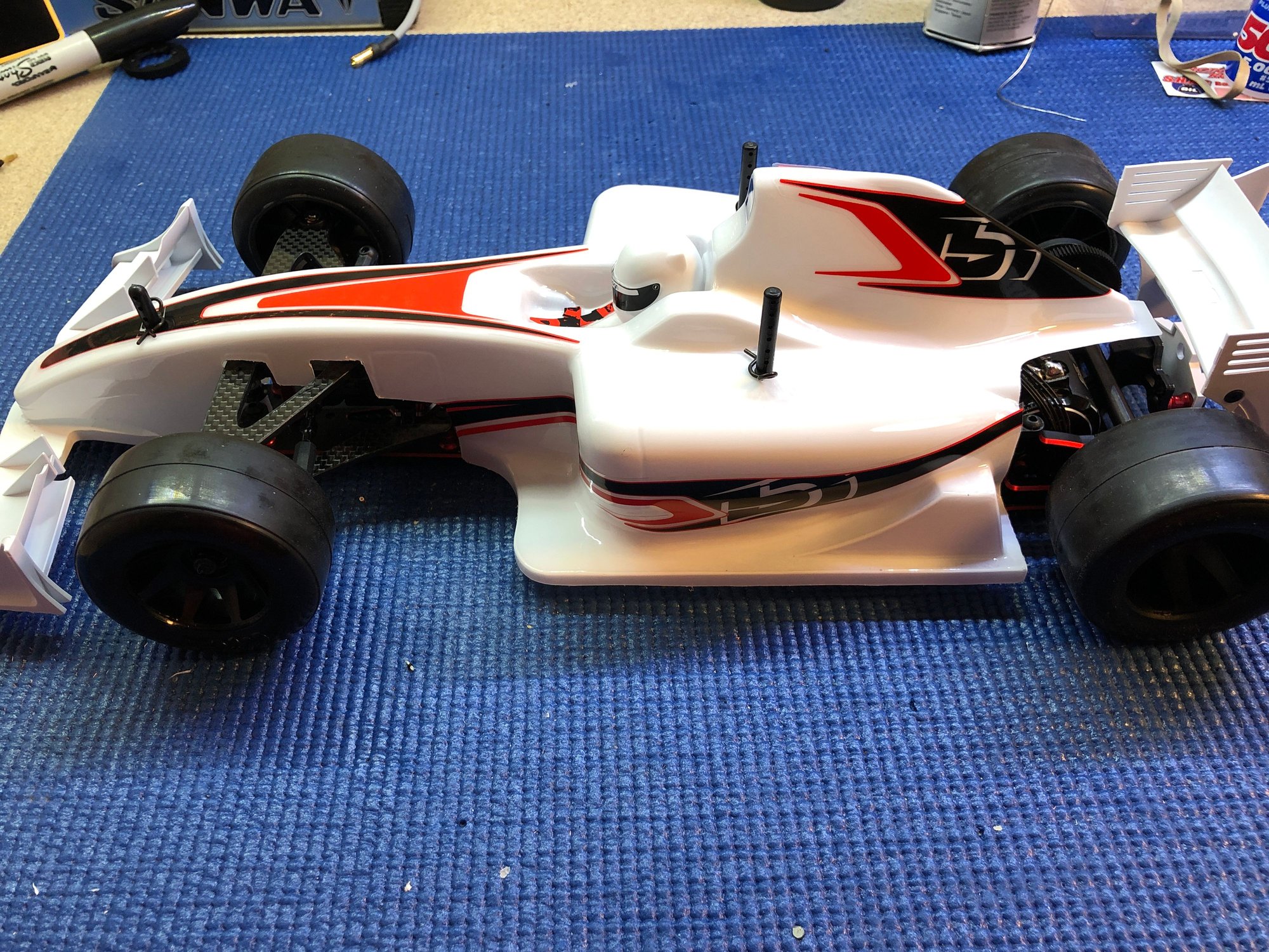

Almost ready to go for tomorrow. It'll be my first time racing F1 and only my second or third race in the last 15 or so years. I wasn't too worried about painting a nice body since I'm sure I'll be a little rough on it while I'm getting used to racing again. I have some 16ga TQ Wire on order, but the 14ga will get the job done for now.

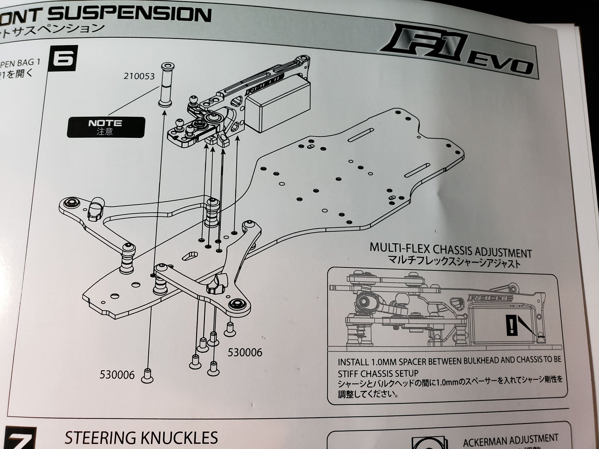

the instructions are vague about use of a shim under the bulkhead. The "main" instructions dont show the use of a shim, yet the inset in the instructions suggest use of a 1mm shim. Not sure if I am to use the shim, if its optional, or its purpose?
I suspect it helps stiffen the chassis? Are you guys using the shim or not?

It is just a tuning option to stiffen up the front end flex slightly. (Really low traction, leave out the shim. Higher traction, install the shim.)

I never use the shim , except black carpet, so never with graphite
play with it see what you like, it's easy
Just don't put a screw in without the shim! big mistake
THANKS, -looking at the instructions I see it doesn't call for one, BUT I could see making that mistake (so thanks for pointing that out).
I may leave it out to start, since I race on both a low-medium grip asphalt track AND a medium-high grip asphalt.
