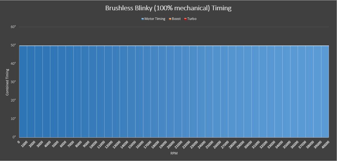

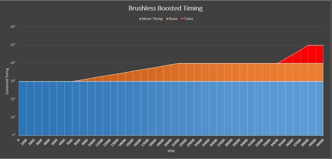

And you, my distant internet acquaintance, make assumptions about me, that don't reflect the difference between theory and reality. I'm also hardly ever touching motor can timing in boosted. a) because I'm not even trying to get to that level of (theoretical) perfection and b) changing motor timing is such a pain in the a**, compared to changing boost, that I don't really care much for it. But that's ease of use, not performance we're talking about. The real advantage of boost is still all about having the possibility to dial in different amounts of timing for different RPMs - or do you run a "boost" with just some static timing-setting from 0 RPM up to max RPM (without turbo)? That would in fact just be pseudo-blinky. It would of course still be easier to use and to change than motor-can-timing, but performance-wise there'd be no difference.
Examples (with random values as this is just about the principles):
Blinky (fixed timing):
Pseudo-Blinky (same fixed timing, easier to change, but otherwise identical):
Boosted (different timings, higher performance and increased efficiency):

ill back steve up, he does actually know what he's talking about. I only ran boosted for a short time. almost never adjusted can timing after finding a good start spot on mechanical. same in mod, find a good mechanical start spot and almost never change it. albeit, I wasn't using a laptop at the races to graph everything constantly. just literary "feeling" it through my throttle finger. there's two maybe three threads on here discussing all of this and they are quite informative but long reads.
