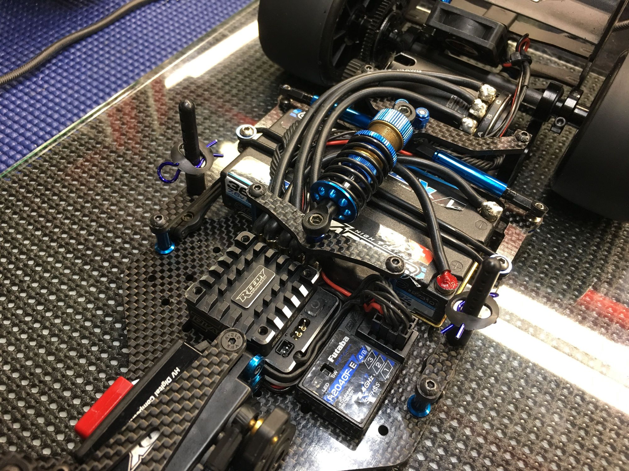

Anyone know if there are any options for retaining the battery via o-ring or something other than tape? Perhaps the Roche plate?

There is a small hole on the side plate.. Drill out and install a 3mm button head screw on the bottom and hook your rubber band around it. You might want to glue the edges of the carbon before drilling to keep from splitting..

This is what I did on my F6. I used to run CRC cars back in the day. So I have gotten used to the O-ring retainer.
