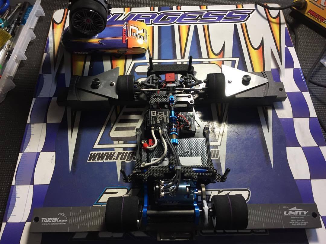

Build went pretty good overall...A couple of notes to Team Associated.... More detail on the direction of the front lower A-Arms would be helpful. The difference is small and its easy to get them flipped the wrong way. 2nd It would have been nice to move the front body mounts out the 1/4in difference so you wouldn't need to elongate your current holes from the RC5.2. This would have been easy as the front mount is a separate piece. Other than that I'm looking forward to a new era with 1/12th scale. Shakedown tomorrow TQ RC Racing
Where did you get that tweak/setup board?
I don't think that thise are available anymore.
E
Hey Eric, going to IIC? Running the 12R6?
I did look it up. They were selling it for about $170
Oh, cool. Yes I'm going. Are going to make it this year? I know it can be hard to justify for you since you guys don't have a place to race anymore.
