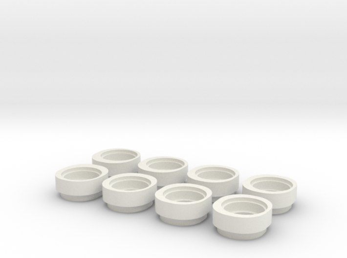

We have a complete solution for this. Chris Kerswell a leading driver here in the UK designed these that are available to us all at Shapeways:
https://www.shapeways.com/product/EC...li=marketplace
We have tested the white ones in the UK team. We do not think the black option ones will come out with different tollerence but my black set are on the way.
This is how the part should have been. The insert properly sits in the whole bulkhead and completely seats the bearing also.
Enjoy and thanks to Chris "Crisis" Kerswell.
M
M
Does this take a flanged bearing?
Yeah standard flanged bearings.
