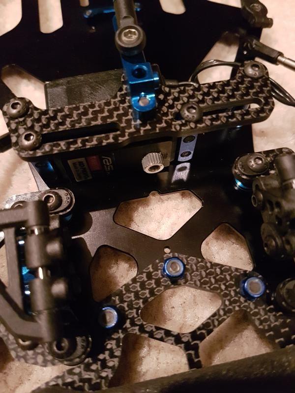

What do you guys do for the steering servo? I cannot get either of the Savox SH-1250MG 1/12 scale servo and the KO Propo RSx12 1/12 scale servo to fit in and center.
First the servos mounting as normally with them in front of the Servo Mount Standoff as per the proper way to install as per manual bumps into the lower graphite suspension mounts and will not slide over enough to center and then even when mounting the servo with the ears behind the Servo Mount Standoffs and bolting them in from the rear, they still don't center even though you can slide them all the way over and then they are too far back by the time the servo saver would even go on you would have to shim up the graphite Servo Mount Brace to fit it on as it is supposed to be in the open area as it sits below the top of the chassis plane just a bit.
Picture is with the RSx12 servo all the way over and that is 39mm center to center of the mount holes vs the Savox 42.5mm center to center which I thought would of make it to have the servo spline center up with the chassis.
190mph is offline

I use the Rsx 12. I just dremeled the right side screw holes for the floating servo mount about 1-2mm iirc and it got me on Center. In your photo notice the right side is bottomed out all the way right, but the left still has room? Grind that right side a bit and you’ll be good to go.
Antimullet is offline

Is your servo in front of the posts or behind like mine in the picture?
The servo does bump into the graphite lower arms in front of the posts.

Behind. I have a ton of clearance.
