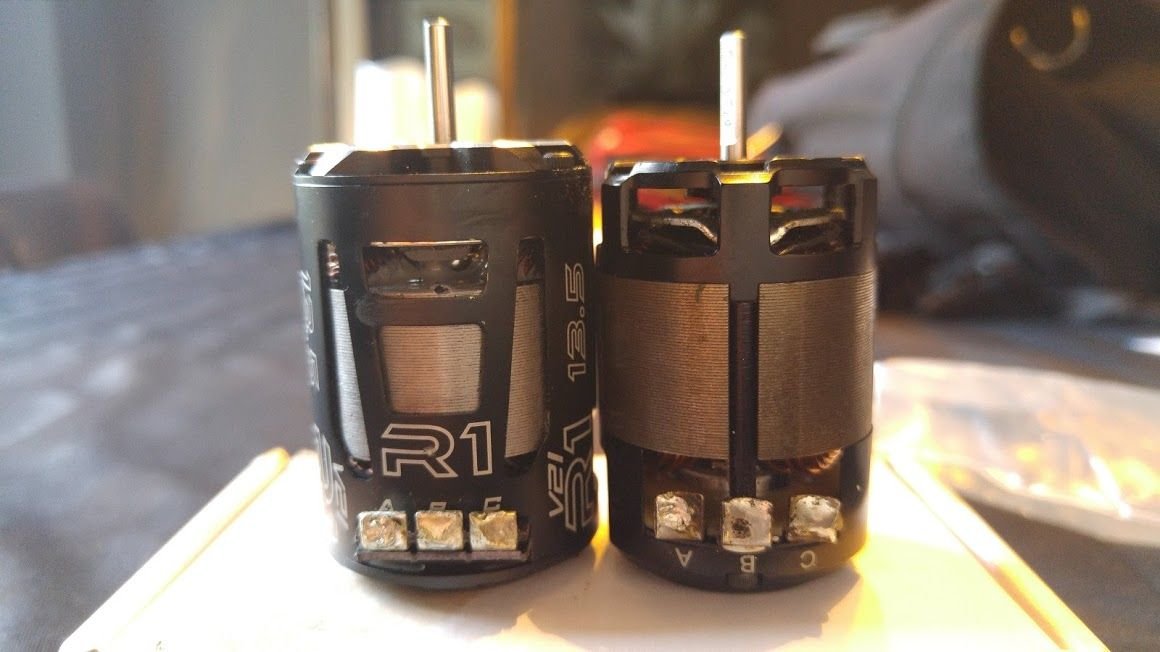

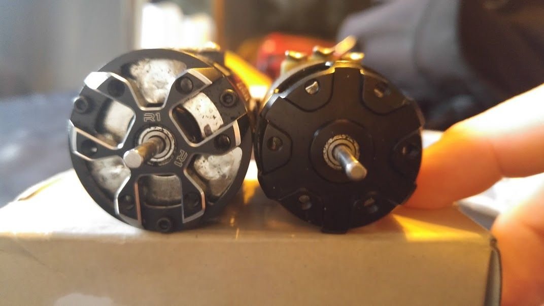

Default Lowrider

Considering that chassis manufactures make a big deal out of lowering a piece of carbon fibre by 0.5mm... these SMC motors have a massive influence on the CG of the car in comparison. Besides the now obvious lower mounting, you can see from the pics that the mass of the stator will move inboard. Plus the motor is much lighter so again you gain in all areas chassis performance. I'm putting a SMC Lowrider in my Awesomatix to build the ultimate CG/polar moment car.

Smc lowriders really lower the CG, but will it be legal for long ? It looks like a 380 can with lots of glue around it....

No glue, just superior design.

It is 540, just doesn't have a "can".
