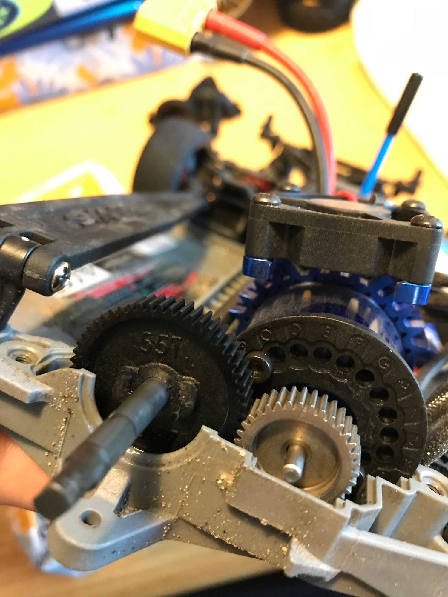

Pretty sure when I went to install the high speed gear set, I forgot to click the retaining pin into the spur gear. Thatíll be a $3 fix lol
Has anyone upgraded the servo saver? Hot Racing has an aluminum one for $18 on Amazon that looks good.

You are better off picking up one of the HR steel spur gears.

I’ll give the Traxxas ones a true test before buying the HR steel spurs. $4 shipped vs $20-25 is worth a try first
For the 2-3 runs that I was able to make before it broke, this thing was stupid fast
Perfect for my strip of road in the neighborhood there's a few guys that have come out with their sons to watch me drive around the last few days
I love that I can turn the power down to let them or their kids try it out

Stripping the pin on the spur is pretty common. Clicking them together is important but not a given that it won't still strip. A support bearing behind the spur helps but the steel spurs are the way to go. Some spare pins in the parts kit is probably a good idea too!

Awesome! Get them hooked!
I've gone through a few of those plastic Spurs. As a matter of fact, there are 8 Tanktecs in my group of friends. ALL of us have ditched the plastic spur gear for the reason you are replacing them. Once you do get the steel gears... You must avoid alloy pinions, and stick with the hardened steel ones. If not, that steel spur will turn them into a roller bearing.

Is the factory 35T "high speed" pinion made of alloy?
Googling finds me nothing

Hardened steel pinions from Traxxas are black. If it is the grey metal, it's not hardened steel. This does not go for all manufacturers. But typically a hardened steel pinion or spur is going to be quite dark in colour.
Years ago, HPI released lightweight aluminum pinions, those where black, used one and it had less teeth than I do after a full throttle hole shot... OOPS. lol.

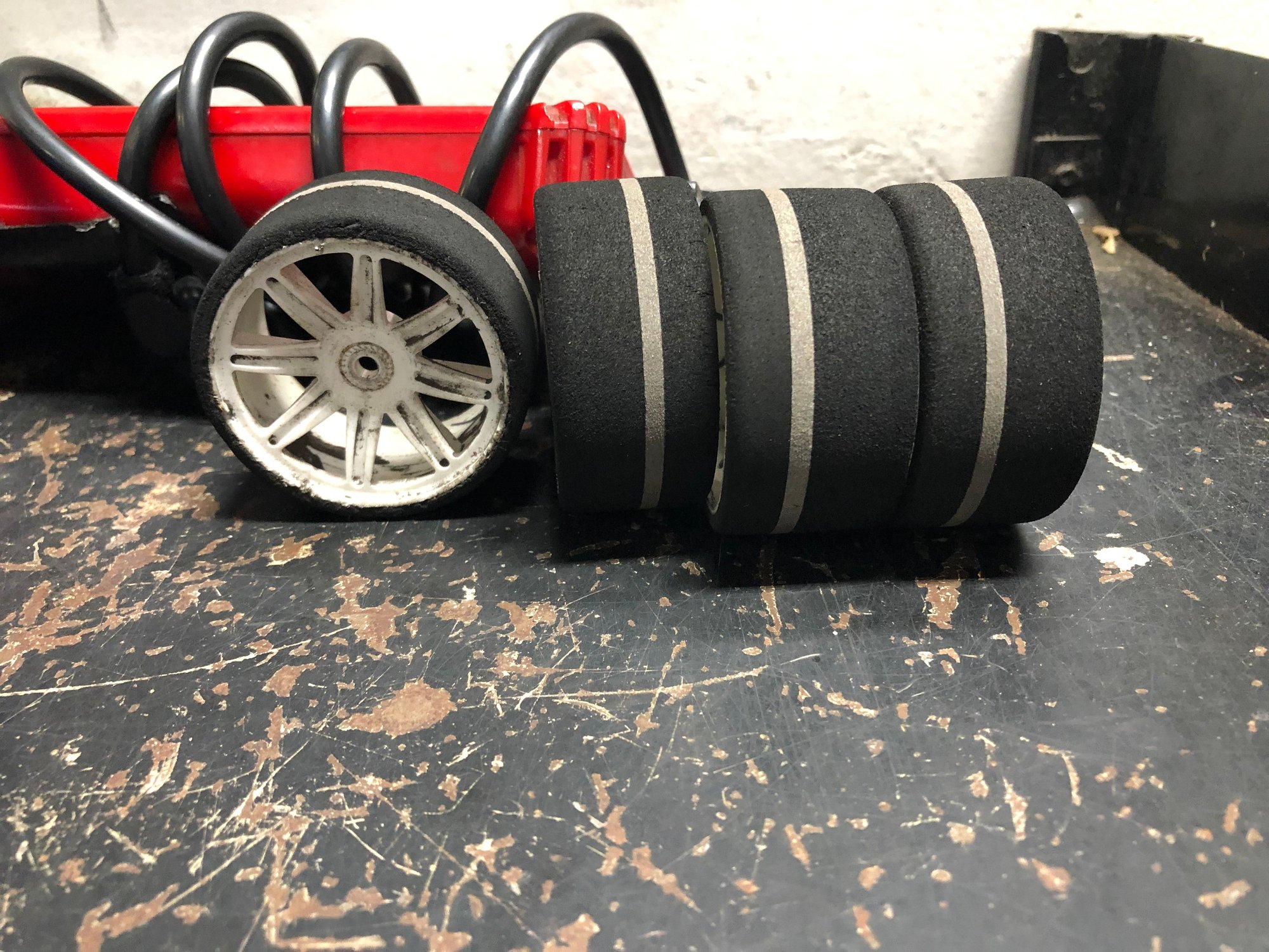

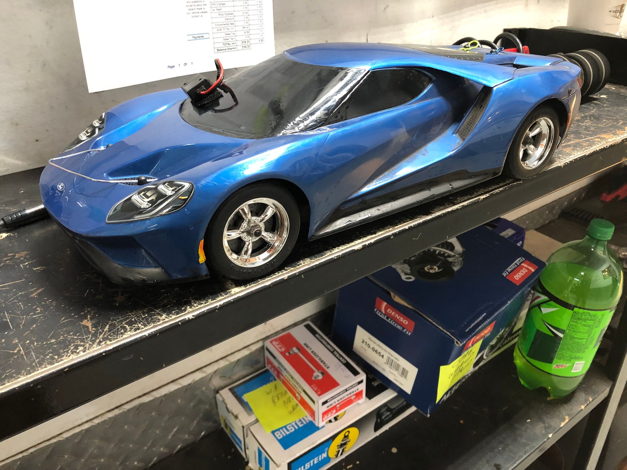

I’ve had the Gravity pre cut foams on since December 5, 2017. Almost all has been unconventional practice. Unprepared pavement. Definitely will try again once find the wider wheel hex. I’ve got them just need to find them. If I was starting a 4Tec race group, I’d really have to consider these as an option. It’s different. But doesn’t take long to adjust
Found a old set of Hpi VTA Tires. At least 7 years old. See what happens.
