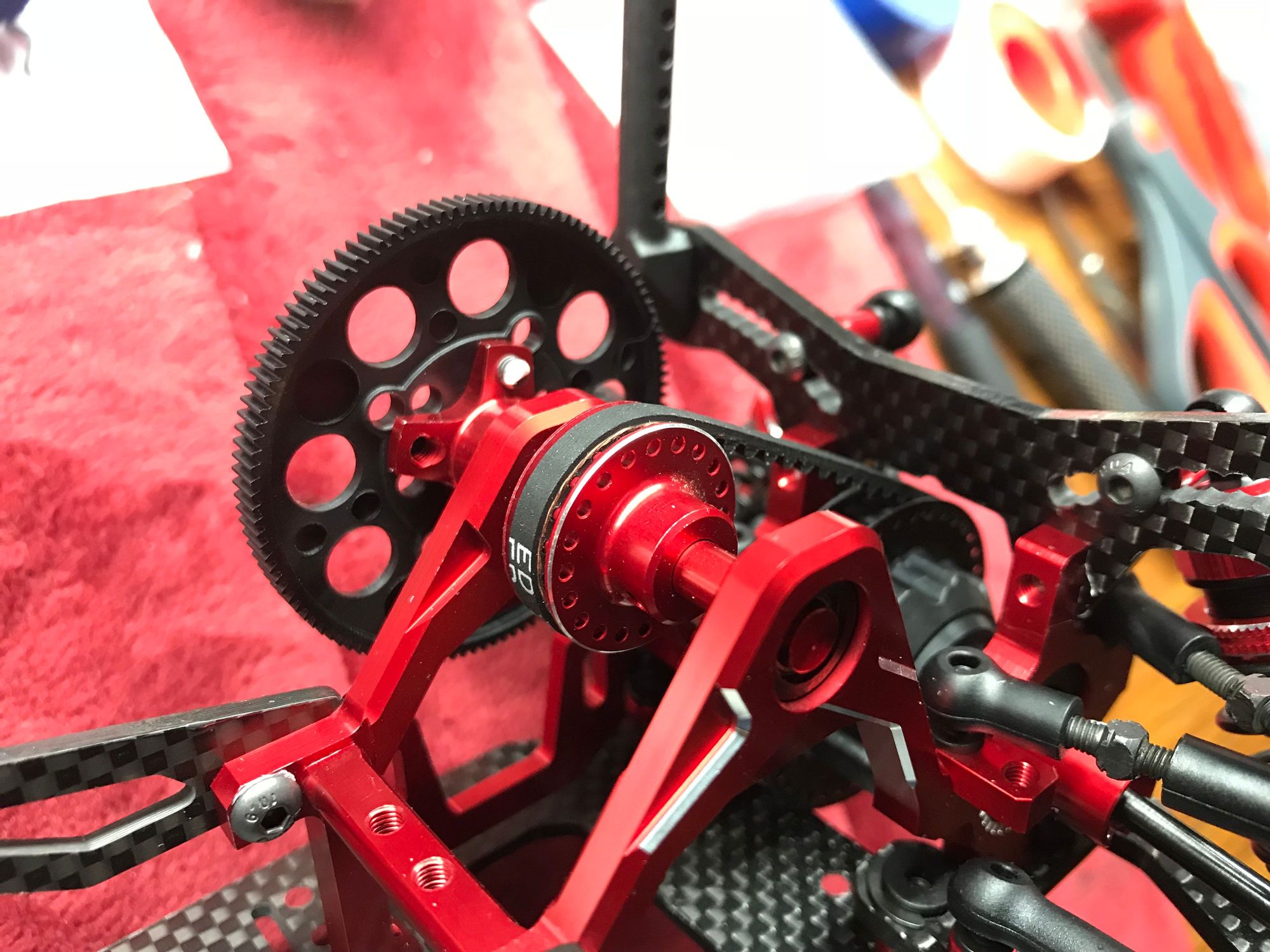

Despite what seems like a difficult and tricky car as Ive heard, Iím going to give this car a shot on american black carpet racing for 2018. Iím mid way through the build and am fasinated by the design. Being RWD Iím gonna try to tune it with a mix of my experiences in FWD mini and F1 RWD
Prior to starting, I purchased the kit with all of the most common parts that Ive researched to commonly break
I also made sure to buy some aluminum hop ups for the pulley and pulley shaft seeing as how that was a common part to strip out
One of the future fun challenges is going to be how to place the electronics. This car has alot of room for several layouts of how to fit everything. Being that black carpet racing at my local club is clockwise, going to try a layout with the battery on the right side
Noteably, building the 12 turnbuckles has proven challenging, but with easier with a caliper and a nose needle bent plier
