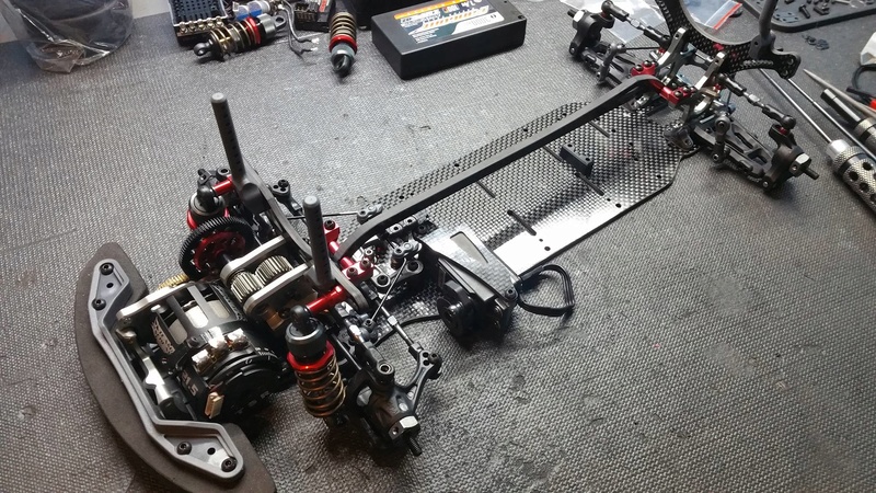

Hi,
Received my kit yesterday and like David says all OK the quality is there but nothing out of the ordinary...I am spoiled by my Awesomatix
Still thinking of the electronic layout. May even consider to relocate the servo at the right side to bring it more inside and keep those wires shorts.
Will keep you updated of tests and development.
The roller without any electronics and option is about 555g/560g so I think it's on the heavy side but not as much as anticipated. Need to compare with other brands.
I am gestimating my RTR to be about 1275g depending of body or battery.
Here are some pictures
