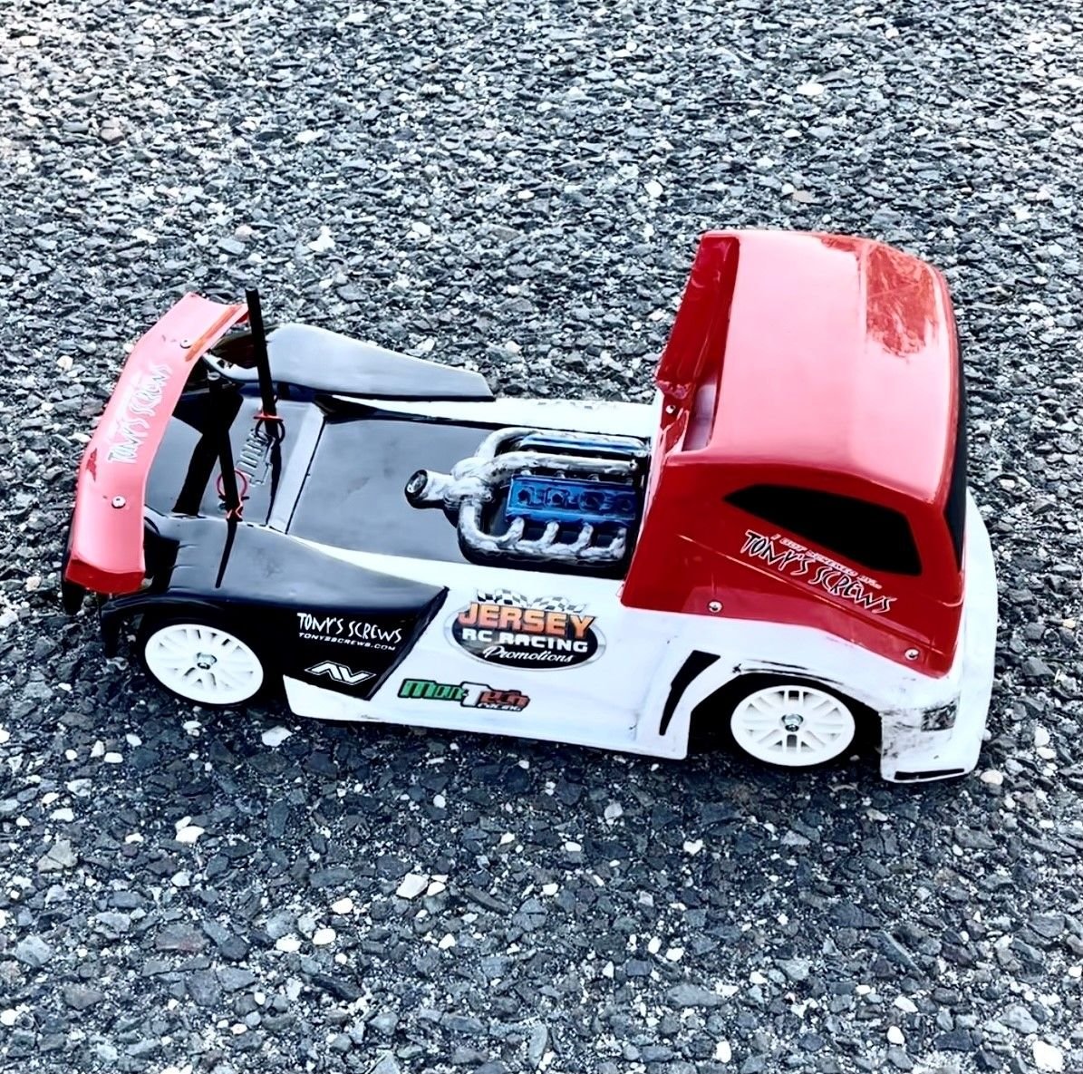

At our local outdoor asphalt track we started a "Super Euro Truck" class. But we didn't want it to get out of control, so we took the lead from the folks running "Box Stock" (TCS) and modified trucks in Europe and came up with our own rule set for the Super Euro Truck class. It's been a blast! The trucks really move and the costs have been kept down.
Super Euro Truck Class:
TAM 53068 - Tamiya "Sport-Tuned" motor (23T motor rated at 18,300 RPMs. Stock "Torque-Tuned" is a 25T rated at 16,000 RPMs)
TAM 54026 - Tamiya blue aluminum center shaft and out drive shafts (must have with the added RPMs and open gearing)
TAM 53619 - Tamiya oil filled shocks (optional Tamiya springs allowed) (makes a HUGE difference handling)
TAM 53666 - Tamiya aluminum motor mount (not necessary)
TAM 53662 - Tamiya turnbuckle tie rod kit (not necessary, just another tuning option)
TAM 53569 - Tamiya aluminum wheel hexes (not necessary)
TAM 53673 - Tamiya 2* rear toe-in uprights (not necessary, just another tuning option)
Open Gearing: Tamiya options only with OEM plastic or optional aluminum mount (55, 58 & 61T Spur gears and 19 through 28T pinions).
* with the Sport-Tuned motor and USGT tires most guys are running 25/58 or 25/55 on the large outdoor asphalt track we run on
Tamiya bodies, MonTech and Bittydesigns Truck bodies
Gravity R/C USGT Tires (or you can run the OEM Euro Truck tires)
OEM Tamiya or HobbyWing 1060 ESC only.
Shimming is allowed to take out slop in drive train.
ProTek 100C HV LiPo Stick pack
Last Thursday night we ran on-road. In qualifying the fastest lap times:
Stock Euro Truck class - 20.381
Super Euro Truck class - 18.555
In the mains:
Stock Euro Truck class - 20.164
Super Euro Truck class - 18.341
TonysScrews This is a very modest step up from the base Euro Truck rules. I like it. Not a ton of money to move to a more tunable and faster platform.
The lap time difference is impressive.

It's a lot of fun and very affordable (I edited my original post and added prices from Amain). Our Super Euro Trucks were actually faster than all but the fastest two VTA cars and they're running 25.5 brushless motors and ESC's with a car body. I think once we get settled on the gearing, shock set up and diff setup we can get quite a bit more out of them. We also have a few VERY FAST on-road guys that have been racing for 30+ years that haven't gotten their hands on one yet..LOL

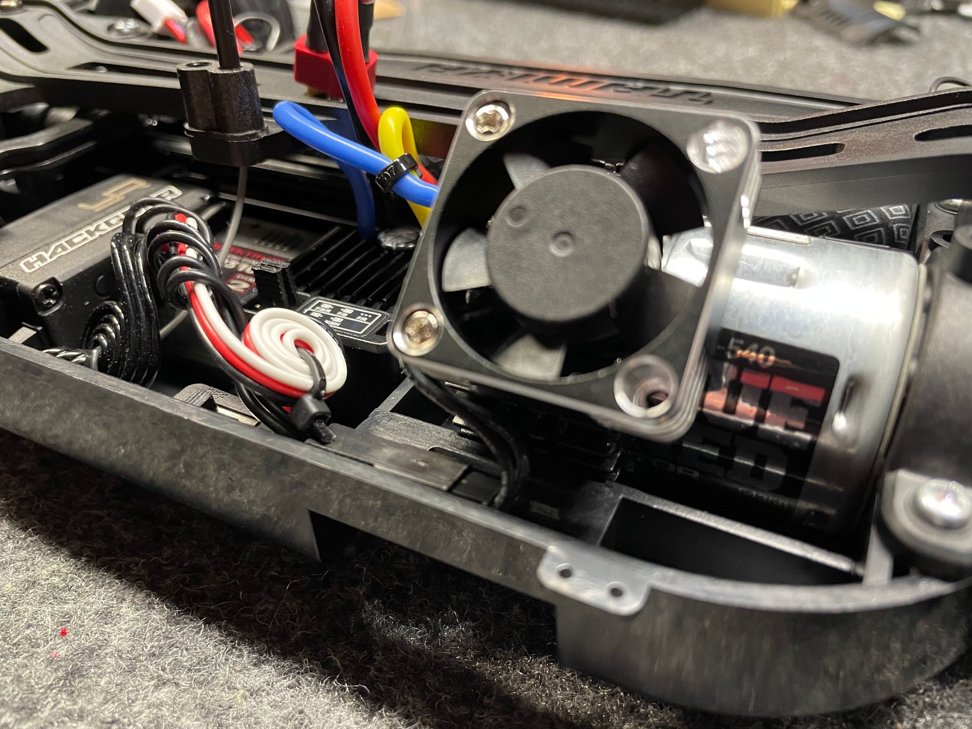

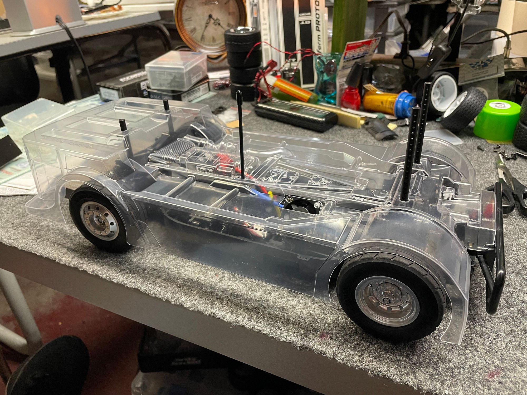

Per TCS rules it says ďbox stockĒ gearing but is that something that is strict at TCS events and at club level or can you gear to track?
I put one together, eliminated the bullet plugs and hardwired the esc to the motor for neatness but once I looked at the rules this is not allowed so Iíll have to go back and change unless at TCS events they donít care. I donít think it will be an issue at my local track.

If you run in a TCS sanctioned event, you must run stock gearing and the bullet connectors from the ESC to the motor.

At Galaxy RC Racers in the Seattle area, we do tech for wires and gearing, but only for TCS. Weíre serious about keeping the competition within the rules.
For club racing weíre pretty lax and use TCS rules as a guide, but we donít tech.

Good points, thank you.
I will convert everything back to total TCS compliance on my next build, for now Iíll just keep what I have as is, I think my local track is pretty lax. I was just curious what everyone was doing. I look forward to running this class as it seems like itís pretty straight forward rules wise.
While I have my share of toys itís nice to see a class where everything is inexpensive and as close to the same as possible.

I'm pretty sure the fan and removal of the heat shield isn't TCS legal either.

That's correct, at least how Galaxy reads:
16.2 The kit must be built EXACTLY per the instruction manual.

I hang out at Indy RC when I can.
The pics from that build are before I read the rules thoroughly, the next will be 100% compliant, thanks for comments.
