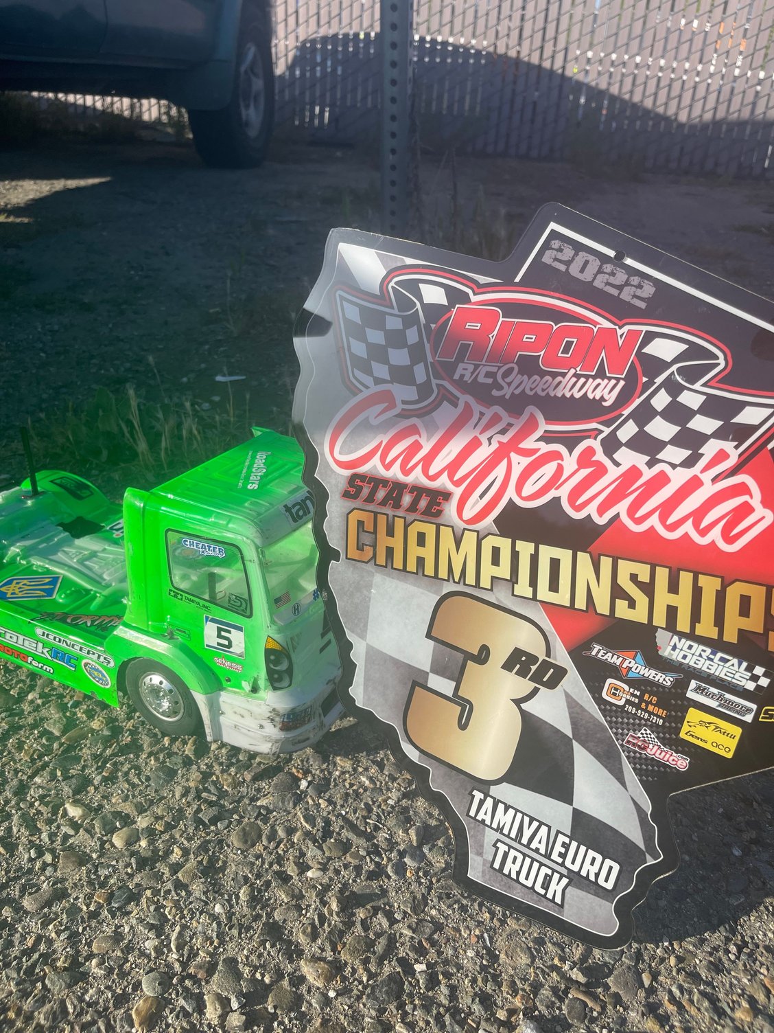

So much fun today, for never racing outdoor onroad asphalt, (only indoor carpet for me.) having 15 trucks in the class and qualifying 5th in the A, I battled back and forth for second and third ending a 1/10 sec behind second place.
Ripon rc speedway is a good spot with great racers and well kept race program.. funtimes.
