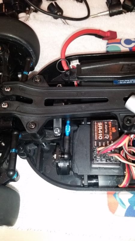

Here is a picture of another one of my TT-01R Type-E cars with a high torque server saver. I didn't like the geometry of the stock servo/steering link on the servo I was using, so I replaced it with a turnbuckle. I replaced the shoulder screws on each end of the link with the ball studs that were included with the high torque servo saver kit. I assume this modification WOULD NOT BE LEGAL for TCS Eurotruck racing.

Yeah, we are following by TCS rules so we can't replace it with a turnbuckle.
I am going to try the single hole high torque servo saver and look for a plastic nut.

Below is a picture of a servo I just mounted into a Tamiya TT01-E kit that I'm currently building. I just installed a Tamiya #51000 Hi-Torque Servo Saver (Black) onto the Futaba BLS451 servo that is in the car.
I didn't currently have any plastic nuts but I did have some used Tamiya steering rod ball cup/plastic ends from one of my Tamiya M-chassis kits. You can see a loose one on the white towel next to the chassis. I screwed the shoulder screw through the servo horn and into the end of the ball cup. I cut off the excess from the ball cup and now I have a quick plastic nut.
If you have/own other tamiya kits, I'm sure you have some left over ball cups laying around in your parts. I hope this information helps! Also a big thanks to angrymelon's post/picture of his servo saver install.
