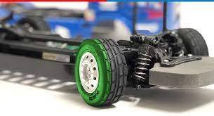

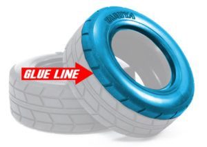

How are people gluing the OUTSIDE of their tires at Apex? Are they just doing the fronts or fronts and rears?
IndyRC_Racer is offline
Old 12-01-2022, 03:56 PM
  #1596
DARKSIDE's Avatar
Join Date: Mar 2008
Location: Nashville-Memphis
Posts: 9,619
just fronts
Phat-Boy and hobbyten like this.

Originally Posted by DARKSIDE
just fronts
Am I the only one that thinks if modifying tyres like this is required, then maybe the tracks just have too much grip?
gigaplex is offline
Old 12-05-2022, 05:25 AM
  #1599
agentorange's Avatar
Join Date: Apr 2013
Location: Jacksonville Florida
Posts: 225
Its not the fact that the tracks have to much grip its the fact that these tires do not have any inserts and when you go around a corner the tires fold onto the side wall and causes the truck to roll over. The glue stiffens the sidewall and allows the tire to hold its shape and slide around the corner and not traction roll the truck.
agentorange is offline
Old 12-05-2022, 05:30 AM
  #1600
gigaplex's Avatar
Join Date: Dec 2015
Location: Melbourne, VIC
Posts: 5,771
Take another look at the picture. The glue is going onto the tread itself to take away grip. And CA glue is far too brittle to meaningfully hold it's shape on a tyre sidewall like that.
If it was purely about the lack of inserts, it would make more sense to allow inserts instead of this crazy gluing.
mrreet2001 and perez62682 like this.
