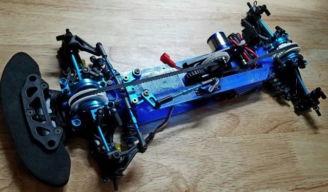

Originally Posted by Speed Chaser View Post
I have a ta07 pro currently one of my favorite tc and am working on this based on some ta07 part. I always had a thing for single belt tc for their simplicity.
How fascinating is this! but it seems you need to run reverse rotation motors, unless your motor is somehow mounted on the left of the car?
foampervert is offline
Old 10-13-2018, 07:56 AM
  #74
Speed Chaser's Avatar
Join Date: Sep 2014
Location: Mars sipping a pina colada
Posts: 3,578
Its reverse rotation motor, it actually an outrunner motor it should arrive on Monday if you want I can take some photos of it mounted on when it arrives. I had to flip the motor mount like that so the belt would not get in the way of the steering system. That photo is kinda old now I had to do a split top deck design to be able to use typical hard case pack that range between 20 to 25mm tall. But I recently found out about ULCG lipo packs which are only 16mm tall and allow me to use a conventional single piece top deck. I am also working on optimizing overall part count the less part the more aesthetically pleasing it becomes to me

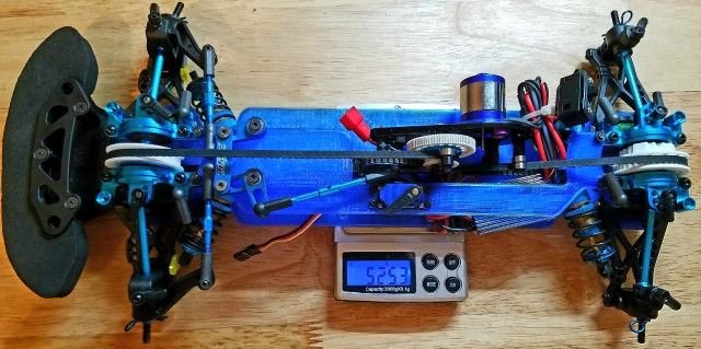

Old 10-16-2018, 12:28 PM
  #75
Join Date: Sep 2014
Posts: 3,578
foampervert this is how the setup currently looks, Today was supposed to be its first shakedown but since Florida had a hurricane my hobbyking order that has the part I need to finish has been delayed. The battery I am looking at is around 130g so it should be around 700 to 750 grams rolling (not including the body).
