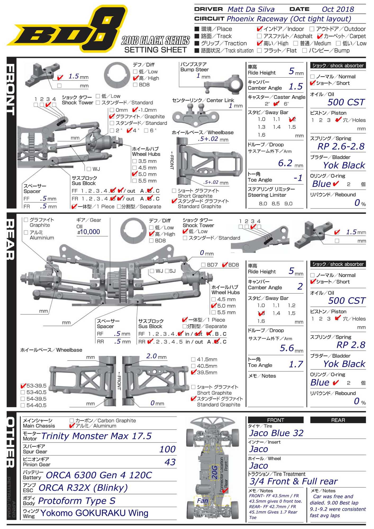

Following up with my current Settings from this month. The car has been awesome, dialed, hooked, fast and repeating good results. I run on CRC black carpet above med to high grip. No traction rolling or weird glitches.. I can put the car where I want and it does what I need it too Posted the set up sheet If you care to reference or get ideas. I still have to try the center pitch rod, I have it in my pit bag just haven't had the test time.

@dasilva3525, nice setup. I'm running something quite similar in our outdoor asphalt track and have my rear toe set at 1.7 and am enjoying the rotation. Are you running a rear chassis brace? Which motor mount are you using?
Curious about your running weight though. I have the same ESC and battery, but running a JP8 with lots of shoe goo and aside from the 20g, had to add 10 more to make 1320.

Thanks, I'm a little late on the reply. I forgot to add I have two 10G weights up front by the steering. I am using the factory 2018 Motor mount (pcs style) But I just ordered the older motor mount and AME Back bone. I heard this is a huge improvement so I am going to give it a shot and excited to hopefully gain more corner speed and stability. Also I bought the 2018 kit as carbon and bought a 2017 Alum chassis on a deal which I have been running. So I'm finally switching to the 2018 Alum chassis as well (seems like a lot less flex). I might try 1.4 toe if the stability is there in the next coming sessions.
Just got a PF D9 painted and mounted, going to test that back to back against my Favoured type S

I tried running 1.4 last Saturday and the car would just over rotate on exit so am going back to 1.7 haha. I'm running a 2018 with the 2017 motor mount and carbon brace from Bezerk, and my 2017 with the PCS motor mount. My 2018 seems to feel so much better with the brace, especially mid to exit.
Good luck with your new gear, looks awesome!
