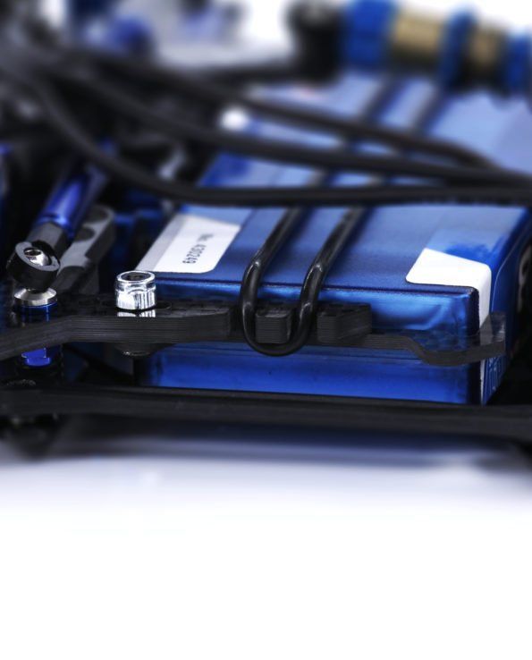

PSM in the next week or two will be releasing their battery positioning/hold down system for the F6 just similar to the RC12 R6 design they currently have below:

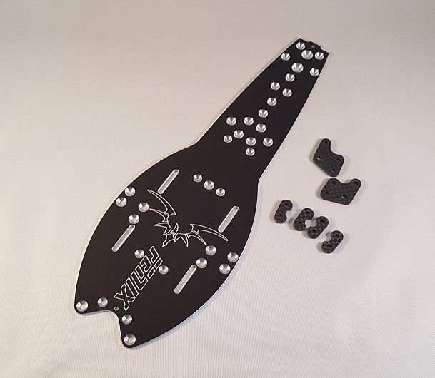

What are you guy's feelings on the Exotek Rear Traction Plate Kit?
I am running on medium grip carpet on a rather small track.

It would offer more flex and would be better suited for very low grip. The battery hold down is a nice touch.
