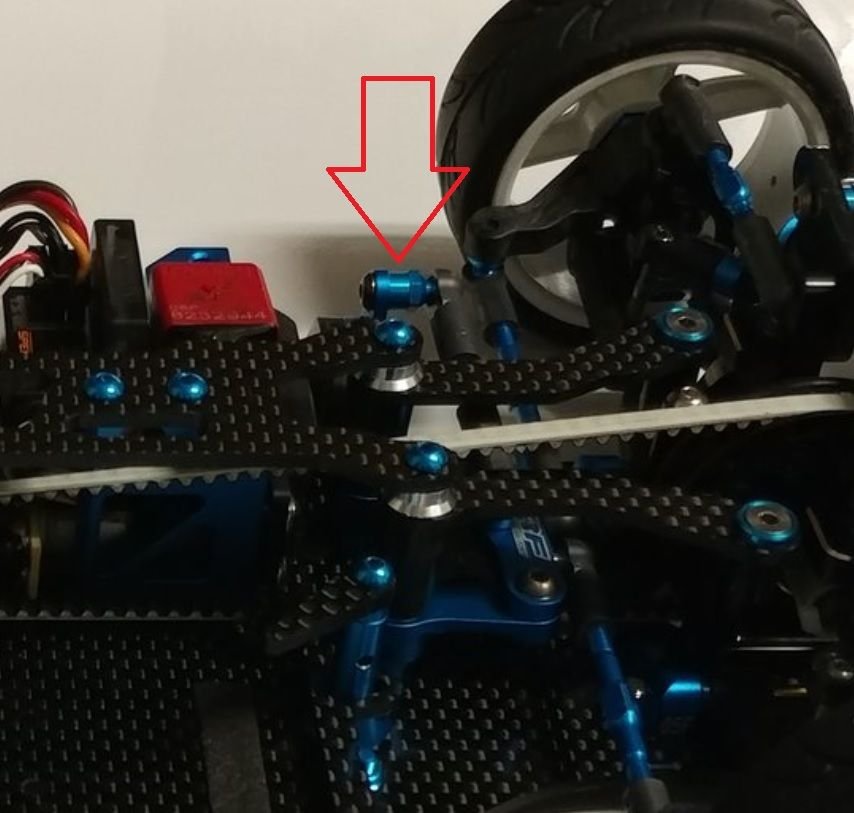

After some testing I decided to add a second mod to the battery holder to keep the battery holders from moving forward upon impact I added a M3 screw and M3 nut in the second hole already provided by the chassis see pic
