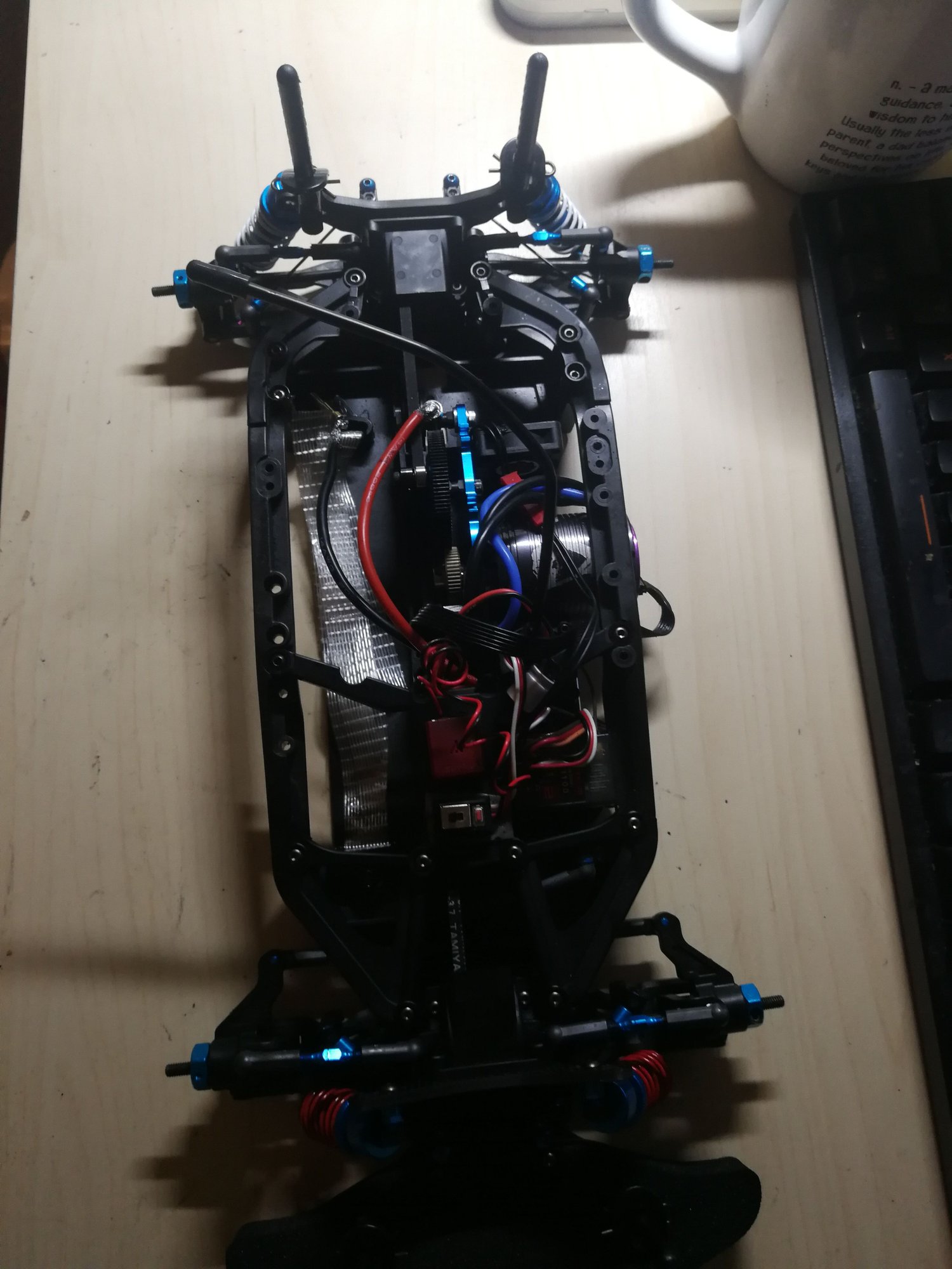

Hi, after turnning some laps at tqrc with the chassis i'd say it is superb. Easy to drive and much easier to understand than my ta06. However, I'd like to know how you guys mount battery on ta07? Unscrewing two holders every time is kind of annoying. Also how you guys adjust the toe angle in front as the stiffner is getting in the way? Just steer the wheel to one side? Plus is it necessary to get the center stiffner (tam54755)? Currently my 07 has the carbon reinforced lower deck installed, the bulkhead and hard stiffner are on their way.
Sorry for the bird nest wiring though.
