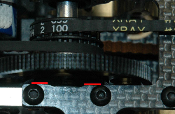

Default PRS Gear Fitment
Originally Posted by HarshGuy
I lightly sanded the one side for the graphite plate, doesn't need much, in the areas in red below:
Hey Guys,
I have made PRS aware of this issue with the new T2 and PRS gears. PRS is looking into a way to slightly change the gear to fit but still keep its strength. Untill then you can do as HarshGuy done or you can counter sink 3 of the holes and use a flat head screw....There is plenty of meat on the PRS to do this.
Thanks
Eric Anderson
PRS On-Road Rep.
