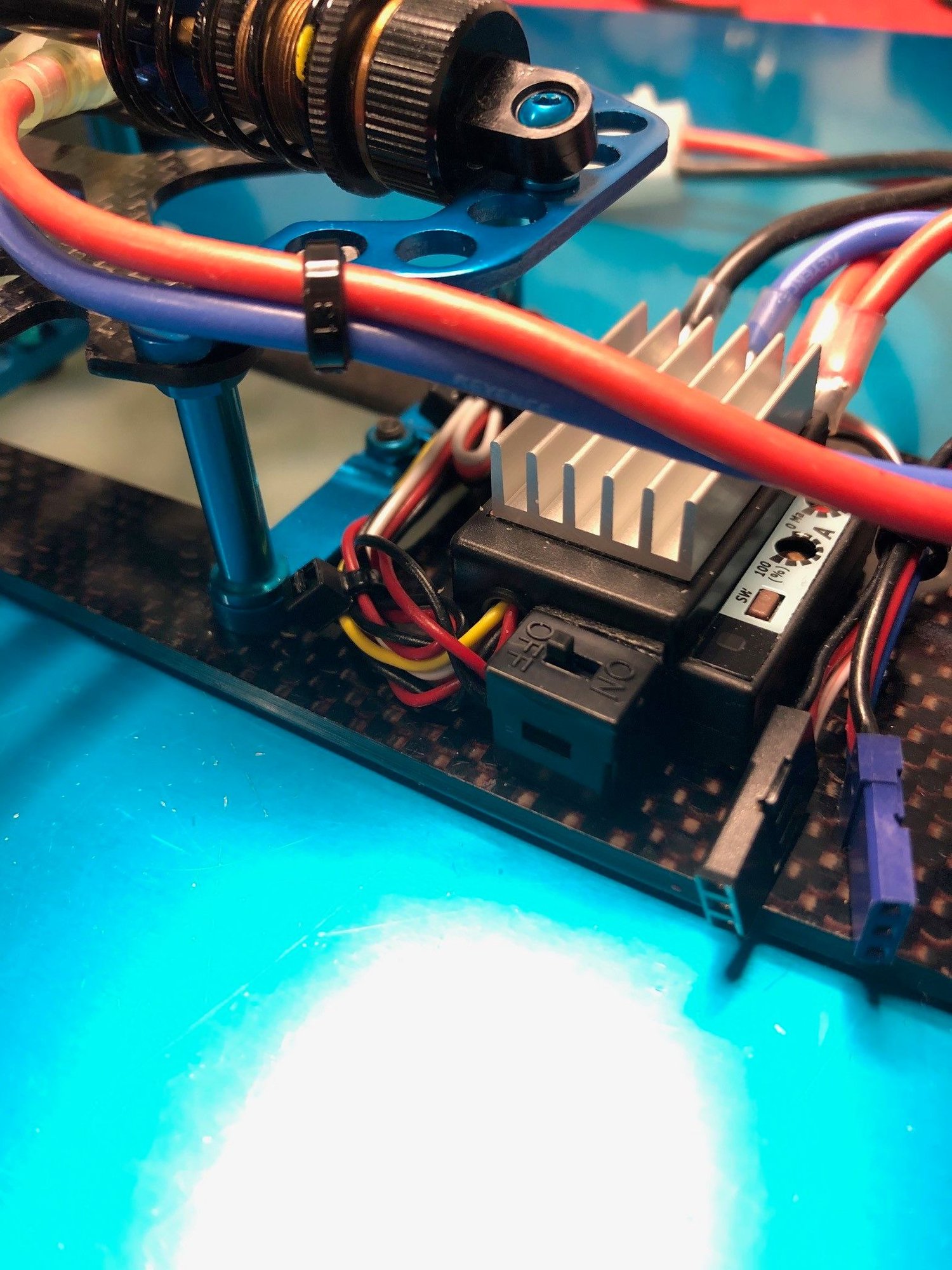

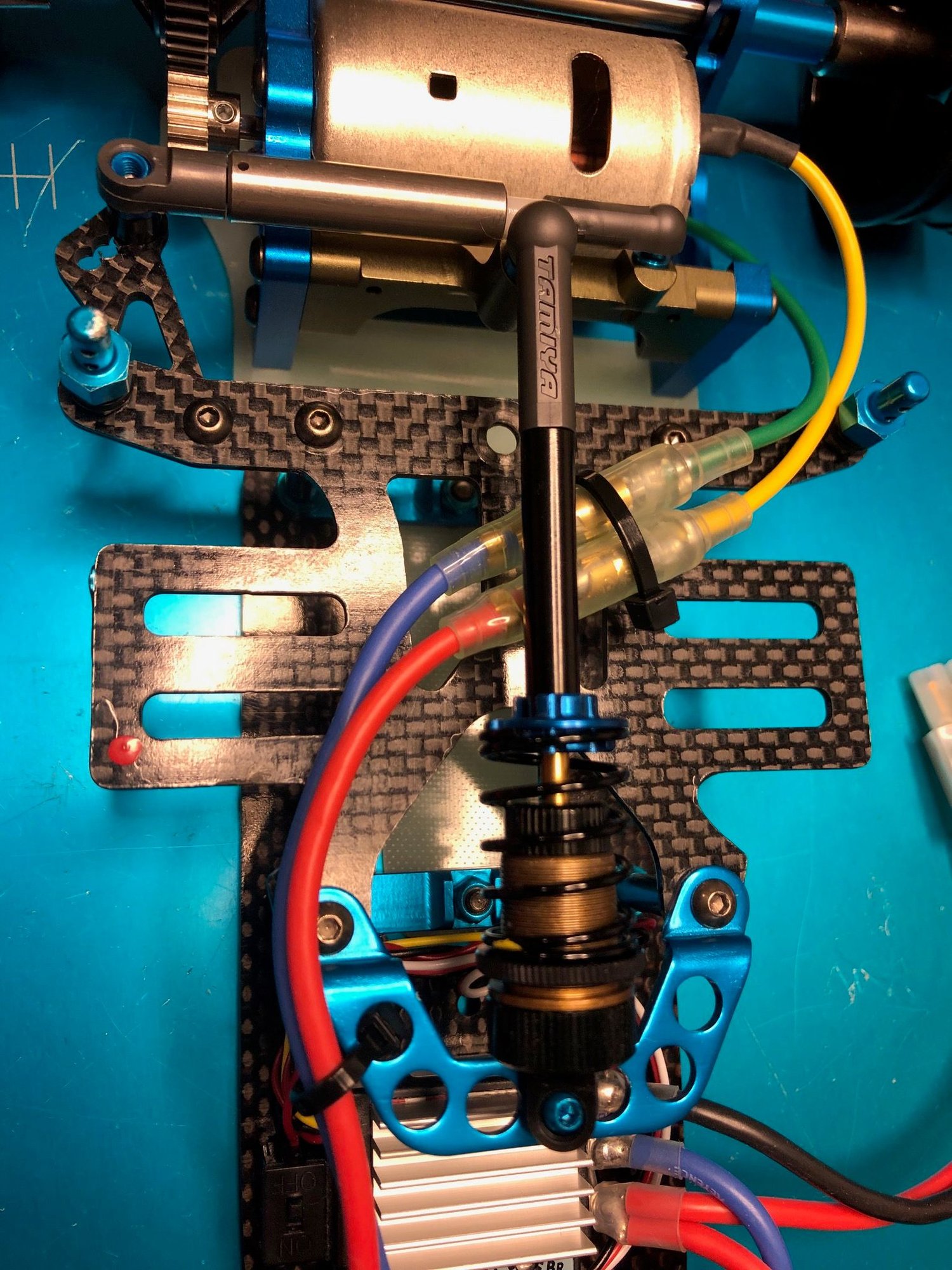

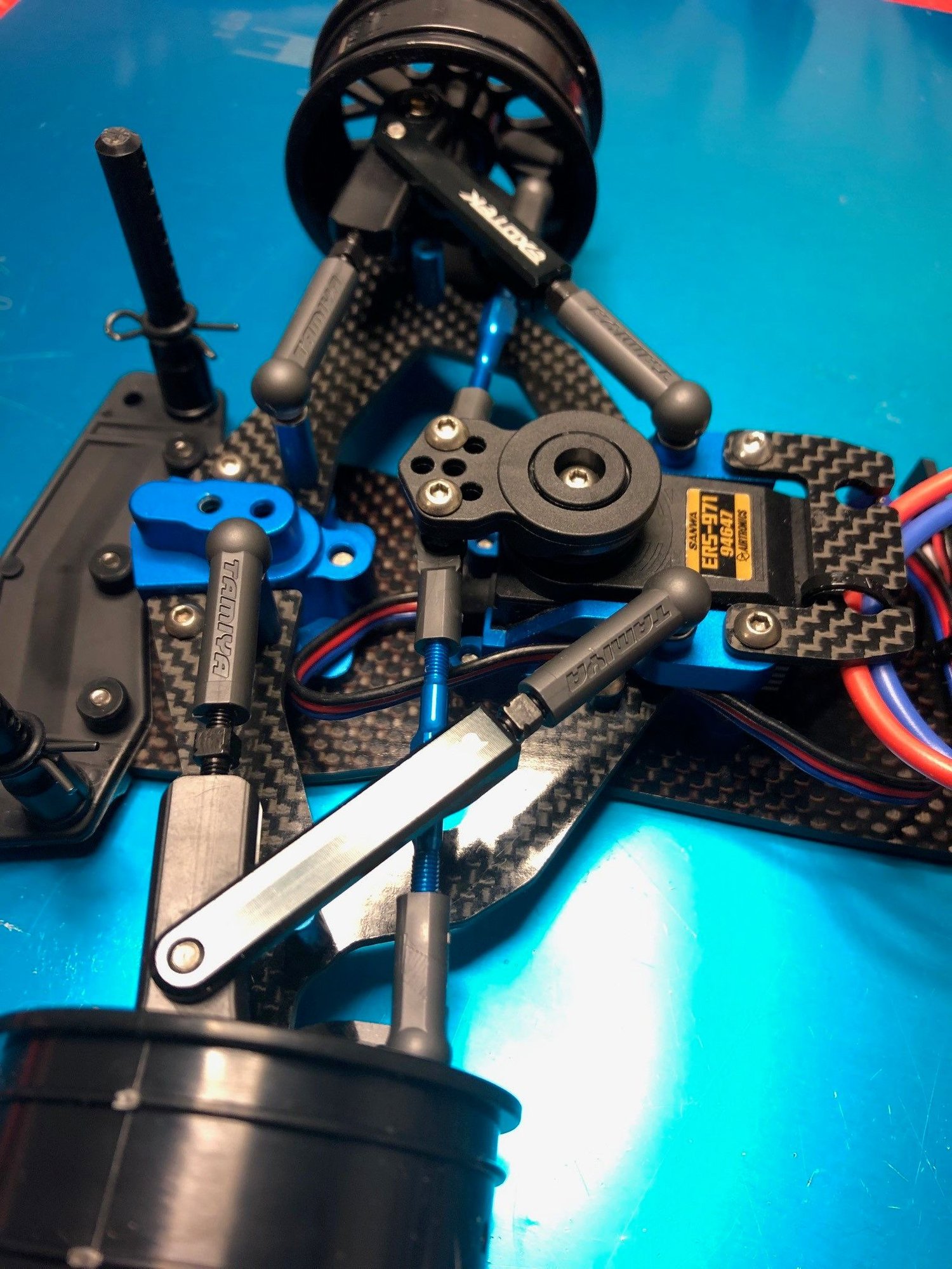

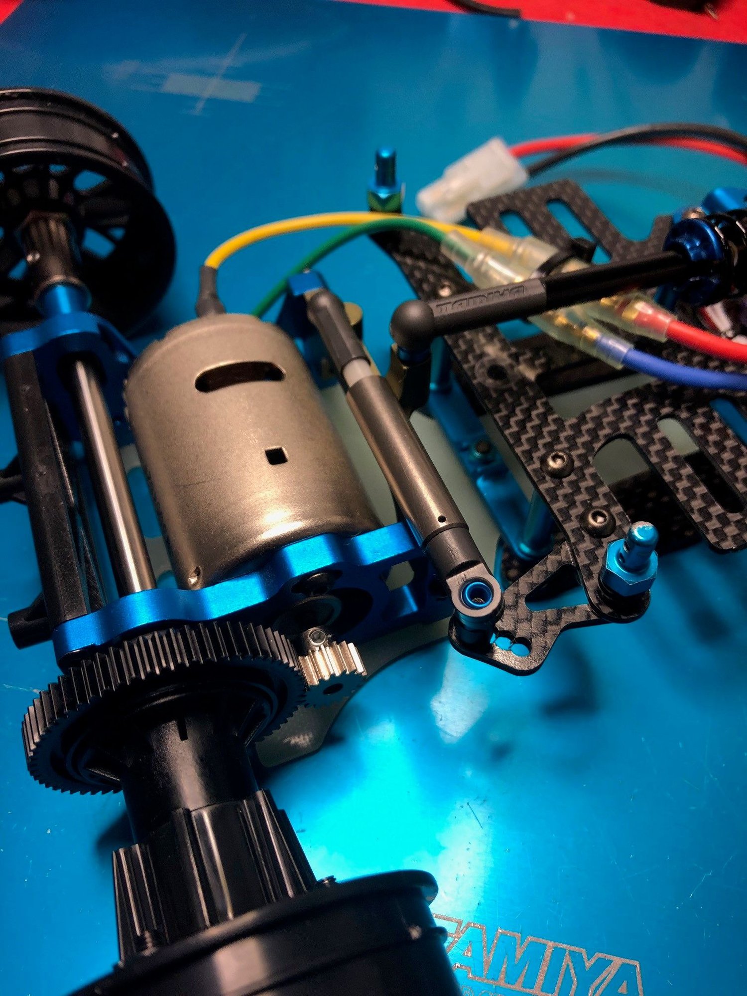

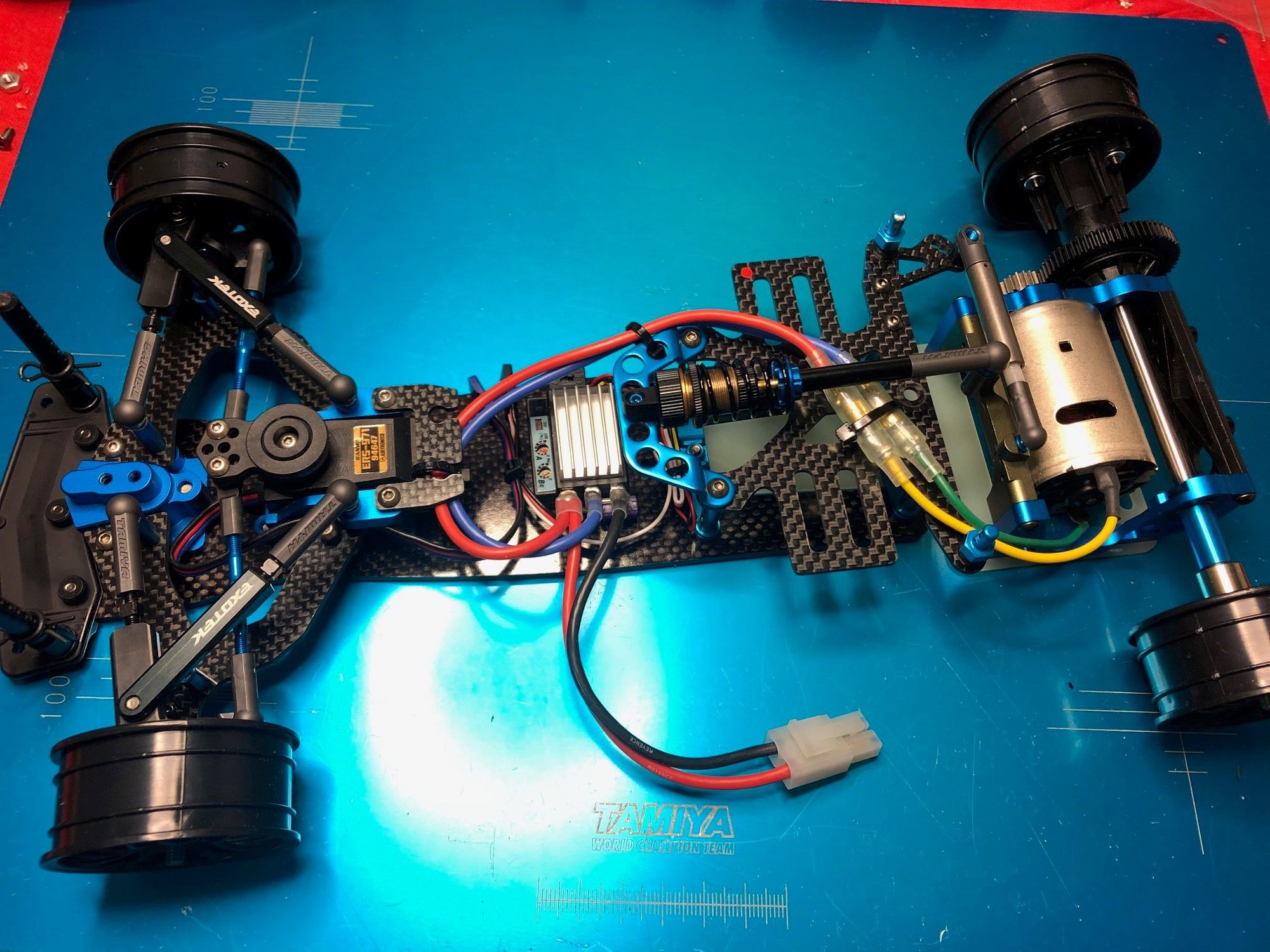

....okay, I found the rest of my GT parts to finally put this back together. If I drive it, I will replace the carbon chassis with the stock one since it seems like the carbon is hard to find. Keyence Exstraight brushed esc, TAMIYA big bore shock, carbon front with Exotek top, and en Xray servo saver

Nice! i like the addition of the side damper.
