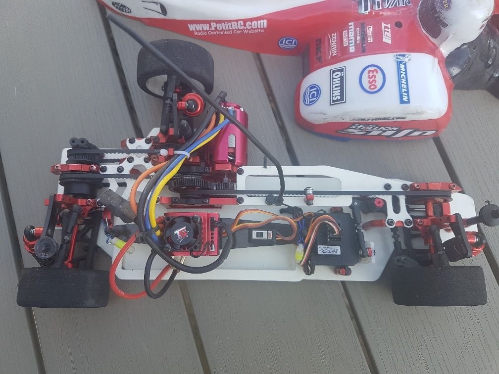

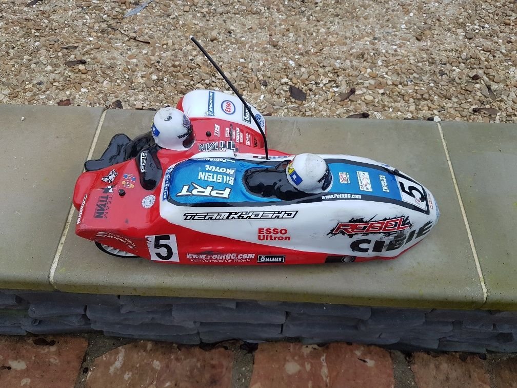

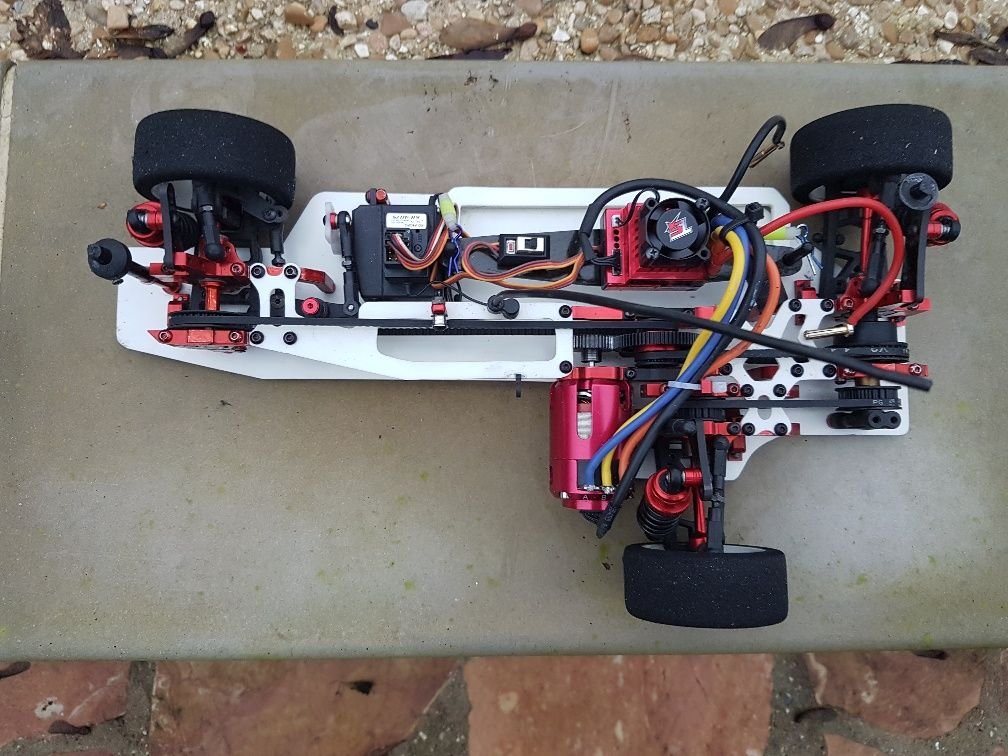

upgrade for race:

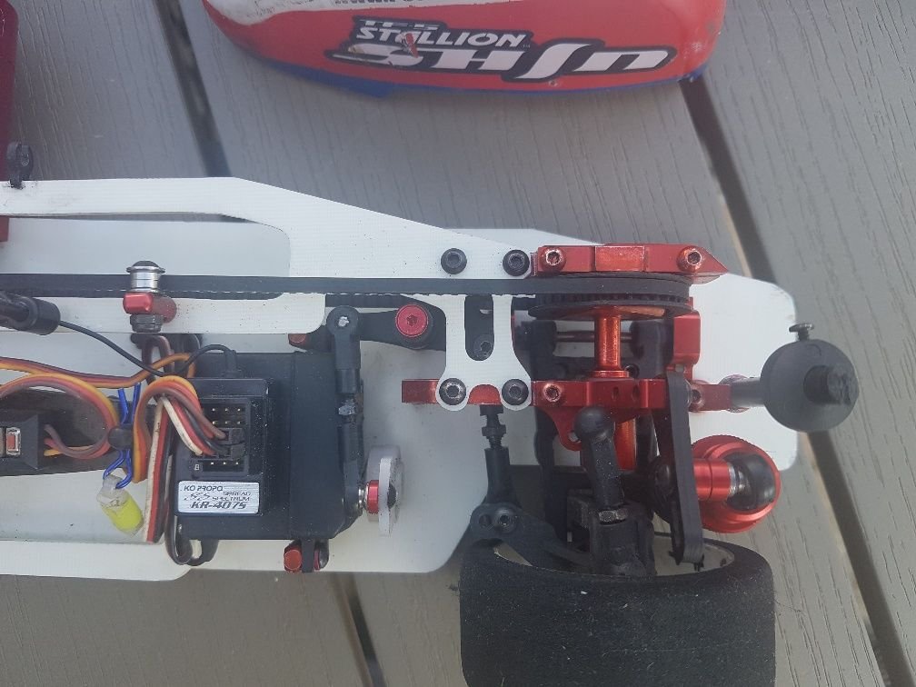

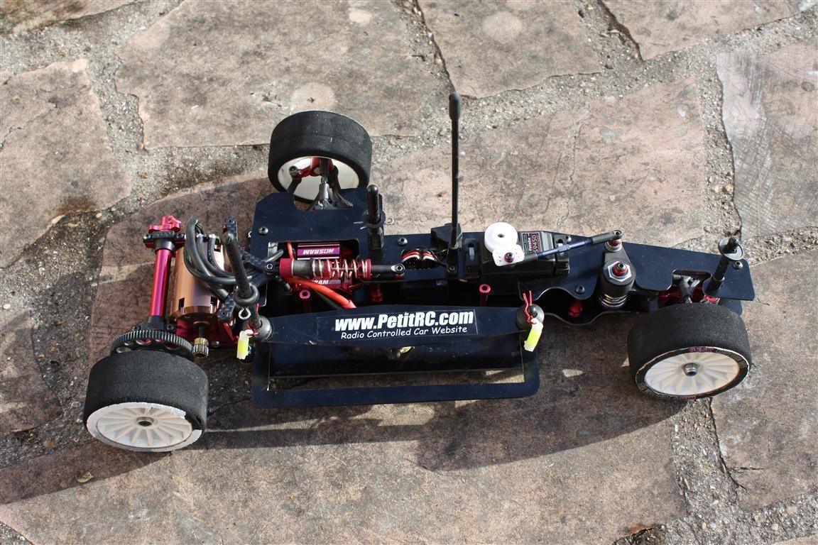

my last 3wd current for sale:

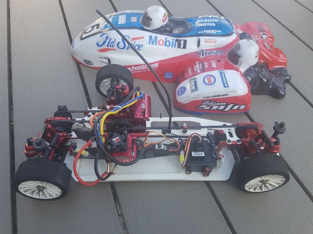

Old 05-03-2019, 05:33 AM
  #48
Join Date: Dec 2008
Posts: 83

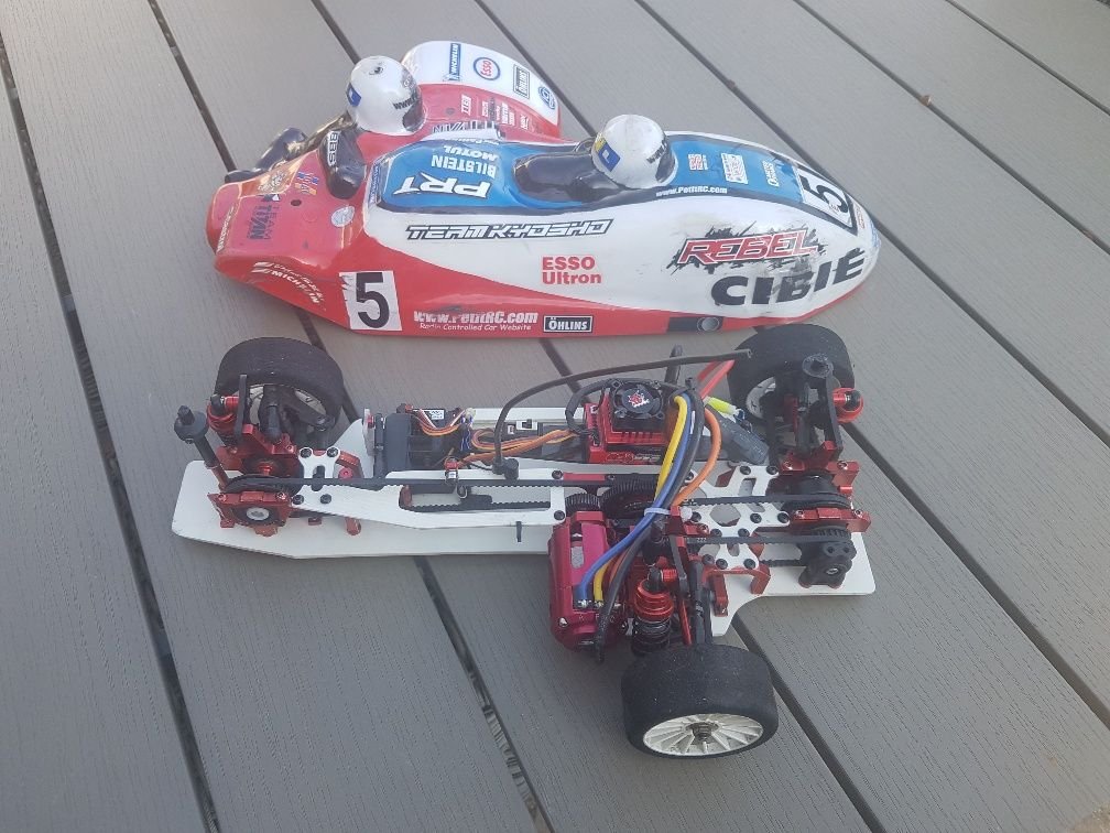

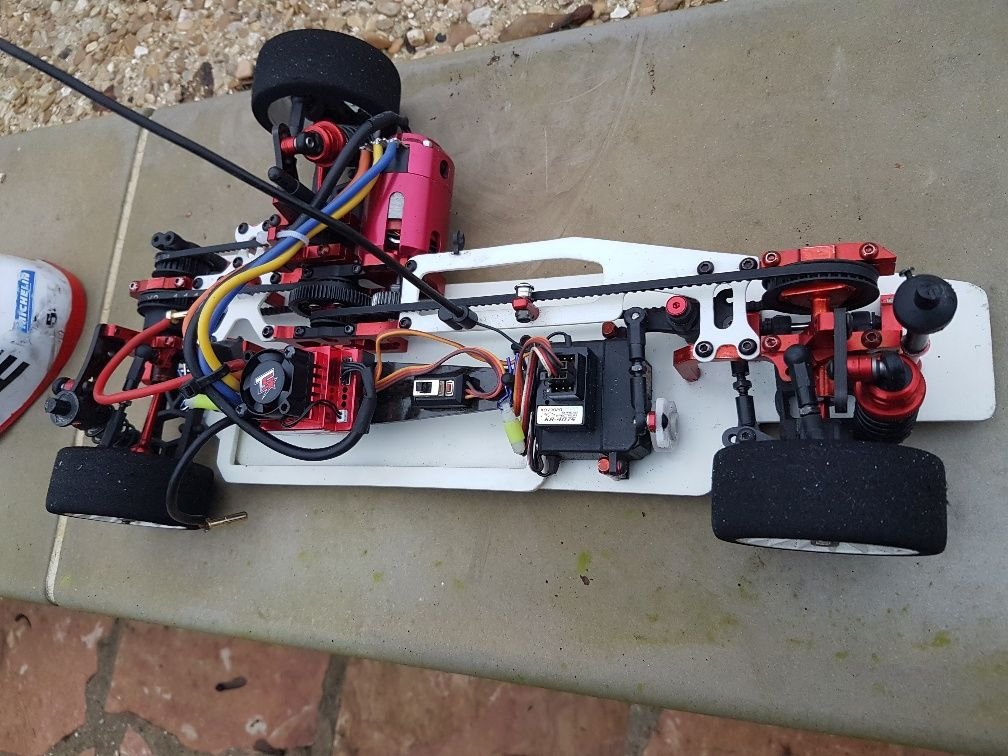

Prepa rain race for my 1wd racing side car in the first French National Championship, I Won this race:
calimerosf501 is offline

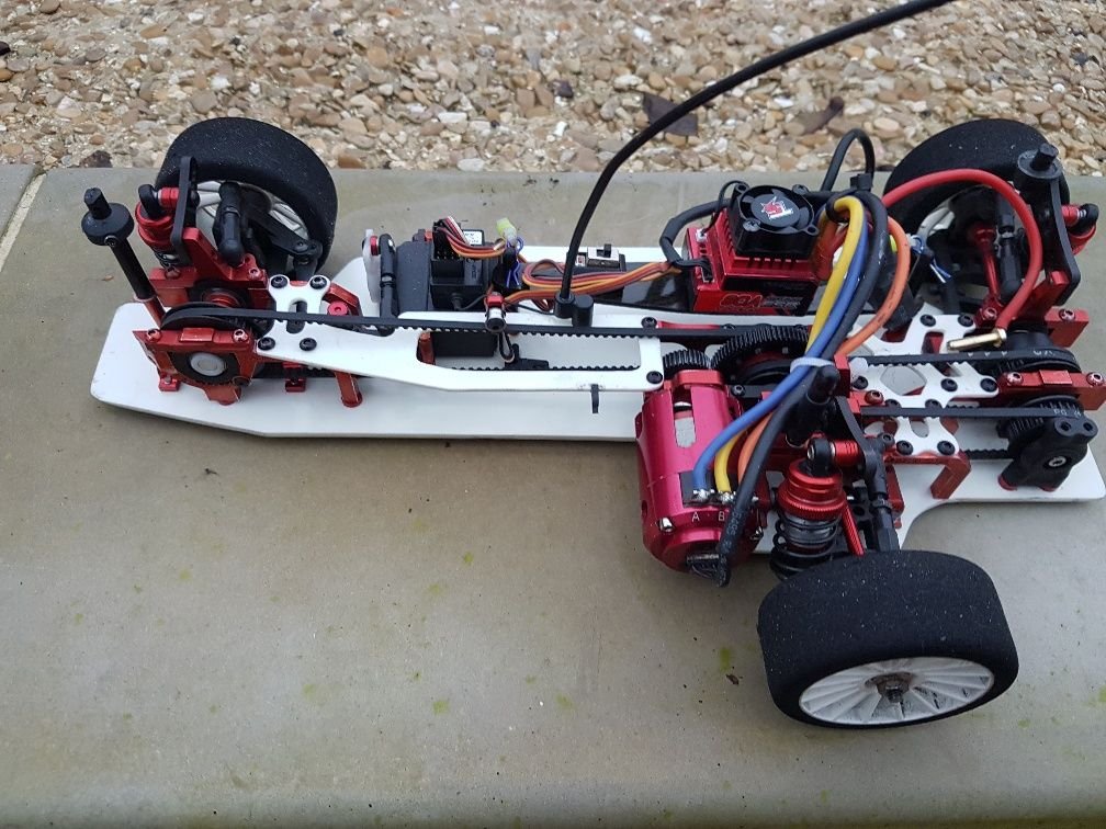

Old 06-07-2019, 07:48 AM
  #49
Join Date: Dec 2008
Posts: 83

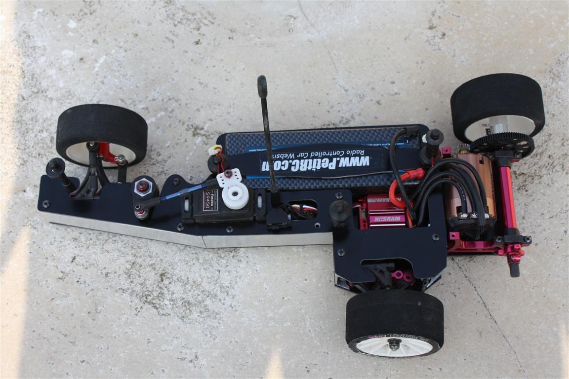

For Ilpo Koivisto of Finland you must make double spring steering like this:
JoeyE and JeffofSpace like this.

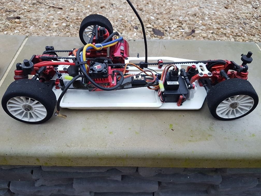

Old 06-09-2019, 08:11 AM
  #50
Join Date: Nov 2018
Posts: 13

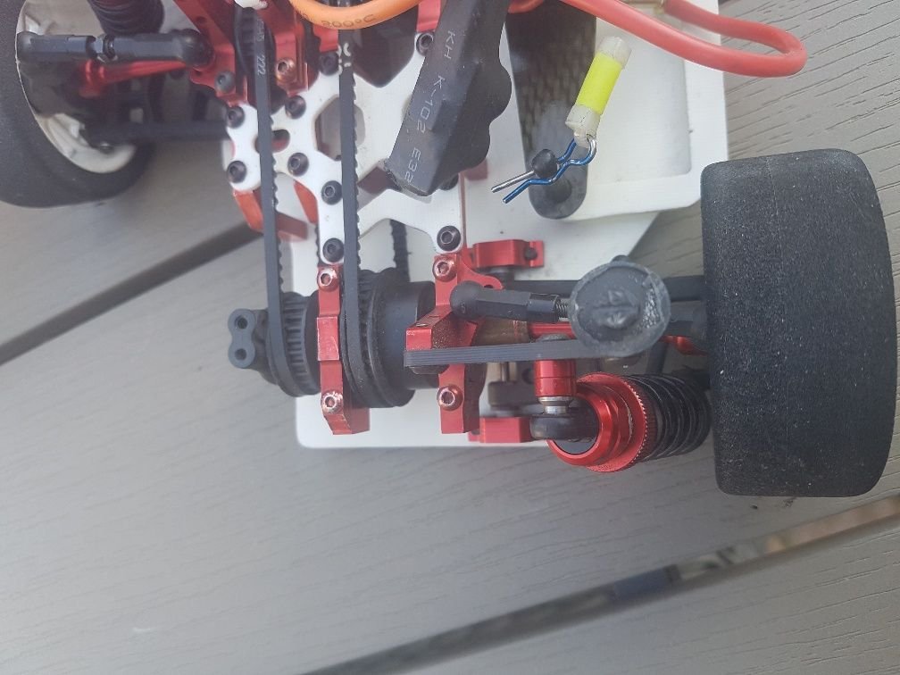

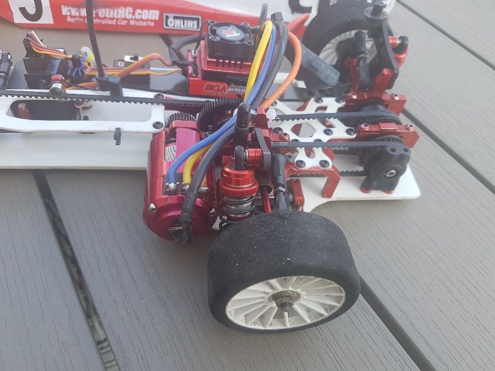

When turning to the right, the side wheel and the rear wheel struggle with each other to determine the direction. When turning left, the load on the side wheel becomes lighter. The bike even comes off the ground. At the same time, the rear wheel tilts and is only partially caught on the road surface. The car spins easily. That's why, when turning right in the right side carriage, the rearman hangs on the right and tries to lighten the side wheel load and facilitate turning. When turning left, the rearman hangs on the left and prevents the wheel from tilting too much and the full width of the rear wheel on the road surface. My own bike doesn't have a moving man in the back. I try to build the car so that all the wheels are always firmly on the ground. I put an additional deck of 50-100 or even 150 g next to the side wheel. And the side wheel turn in the same direction as the front wheel. I am currently thinking and counting and estimating how much the side wheel should turn in relation to the front wheel. Lähetä palautetta

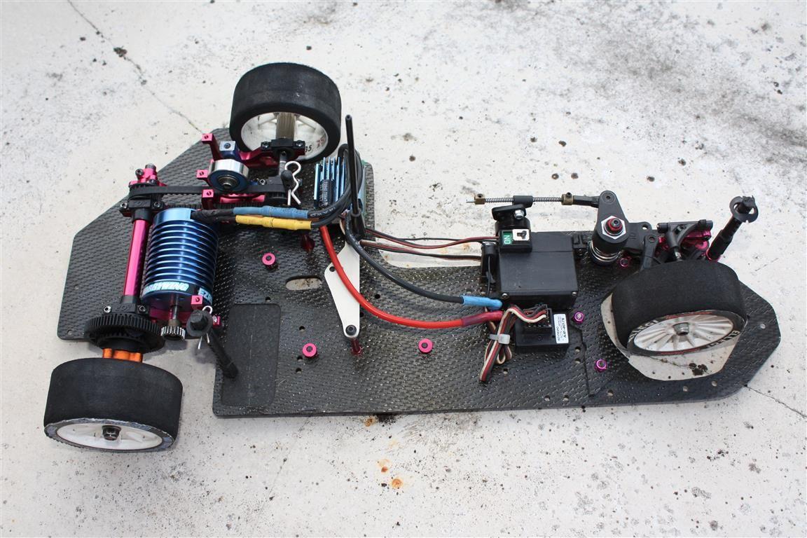

My sidecar pictures: https://m.facebook.com/groups/553034128174034?refid=18&__tn__=C-R

Double spring steering like rc motobike.

Old 06-09-2019, 08:48 AM
  #53
Join Date: Dec 2008
Posts: 83
I say you in private message: no steering on side wheel. Just 1° in, but no more.
I don't see double springs on your steering on your photos.

Old 06-09-2019, 09:08 AM
  #57
Join Date: Dec 2008
Posts: 83
First i test sidecar wix sidewheel toe. I dount faund good setup. Next test sidewheel steeringservo is mix frontwheel serbo.
No servo on side wheel, it unbalances the chassis. Fix this wheel and try another setup.
Watch this vidéo, with y sidecar who won the French National Championship, no steering on side wheel:
the wheel side leaves the ground, the sidecar rises in the left turns, it is heard on the video, but it is controllable.
