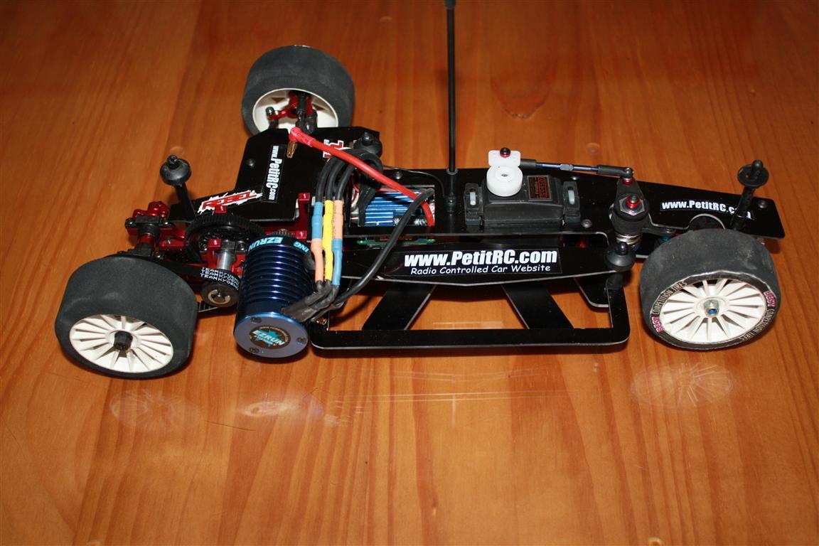

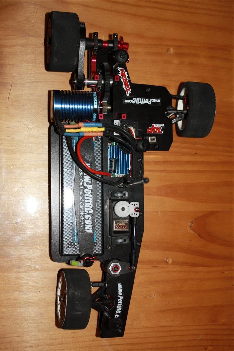

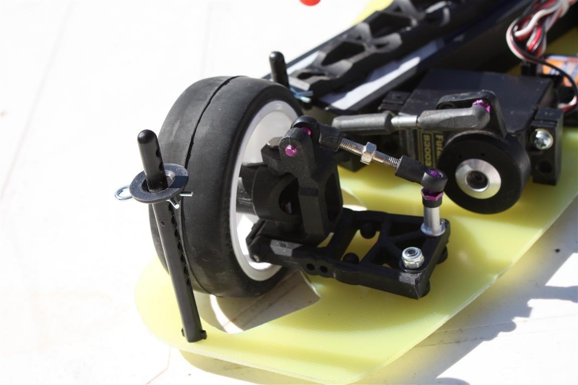

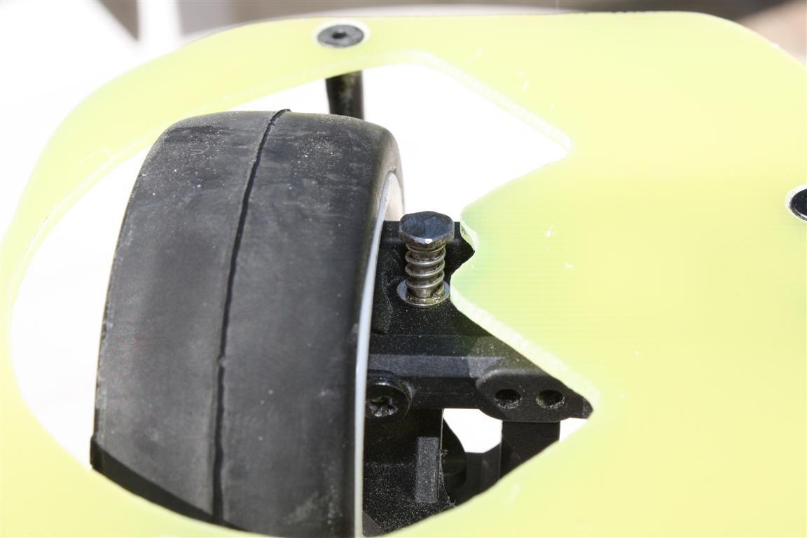

Originally Posted by calimerosf501 View Post

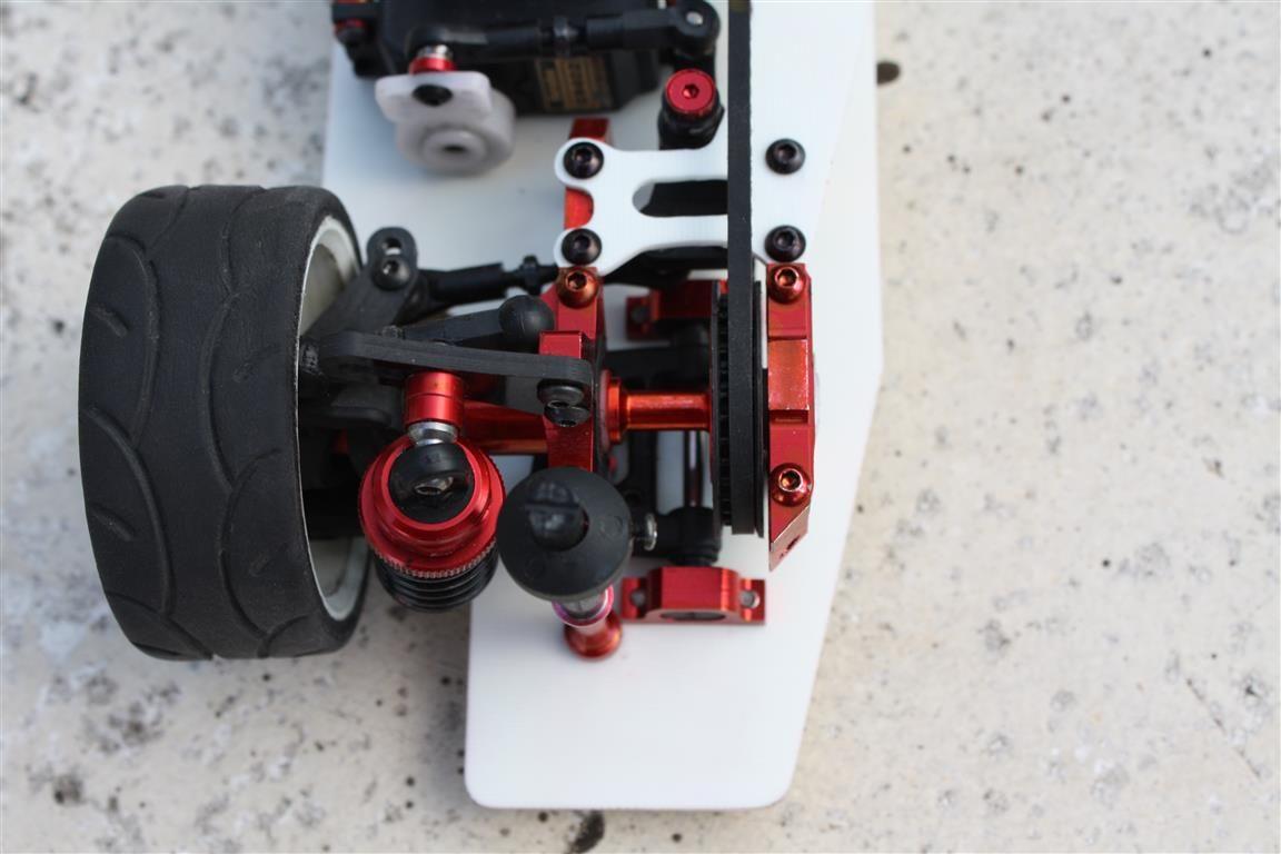

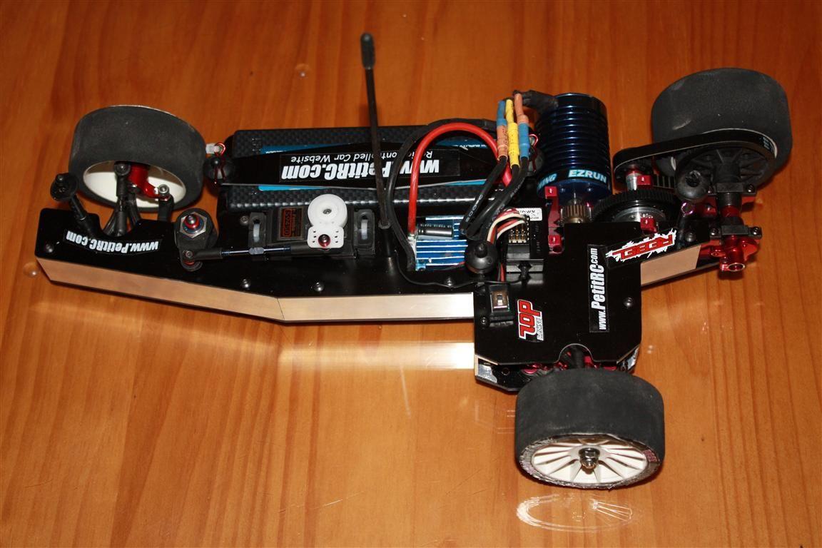

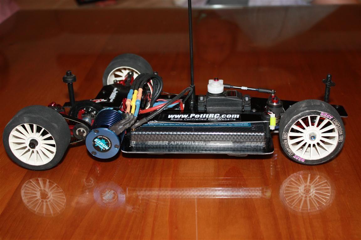

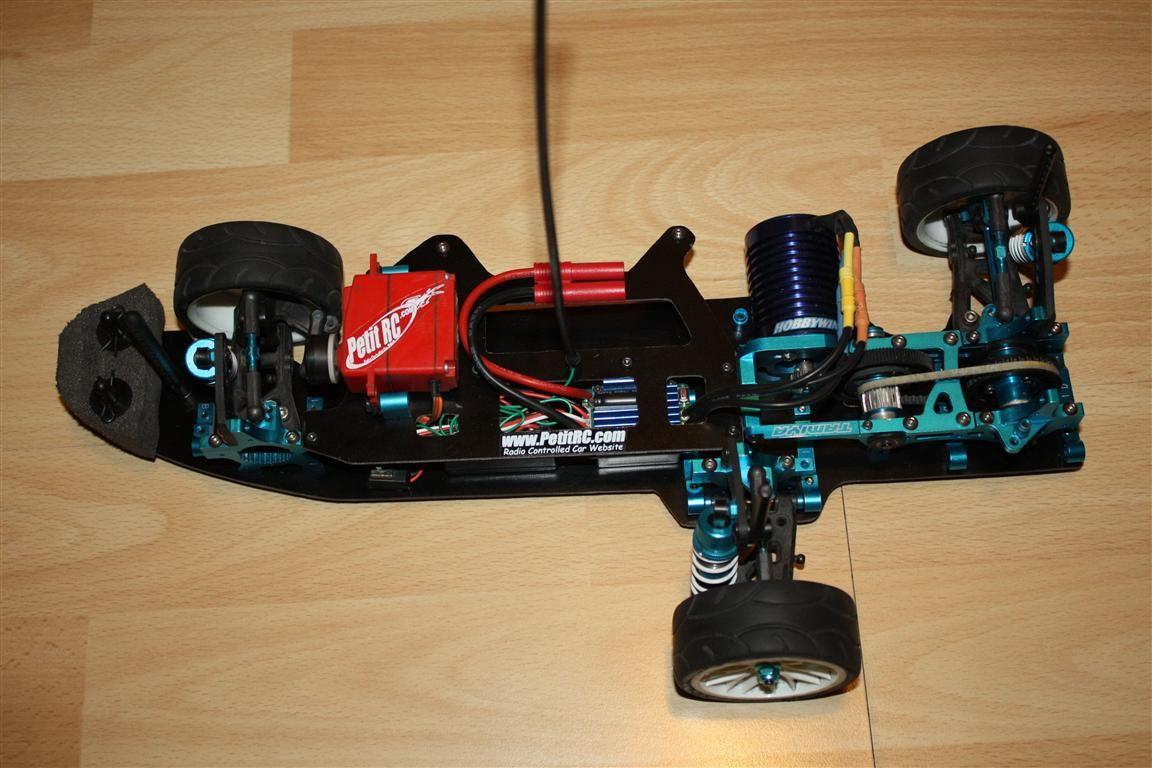

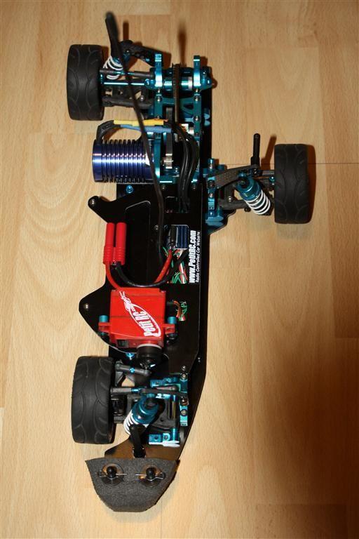

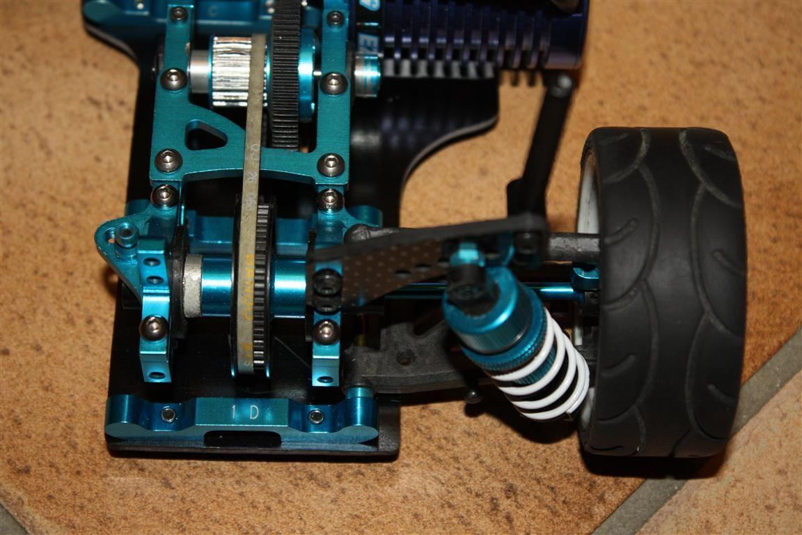

Still a sidecar 3-wheel drive for a buddy, but this time in shaft version and not belts.
Suspension rear right on rocker, suspension in the front fender as on a track 1/12.
here are the pictures:
[img]http://cvandrome.free.fr/IMG_2971%20(Copier).JPG
[img]http://cvandrome.free.fr/IMG_2976%20(Copier).JPG
[img]http://cvandrome.free.fr/IMG_2977%20(Copier).JPG
[img]http://cvandrome.free.fr/IMG_2980%20(Copier).JPG
This is great work!

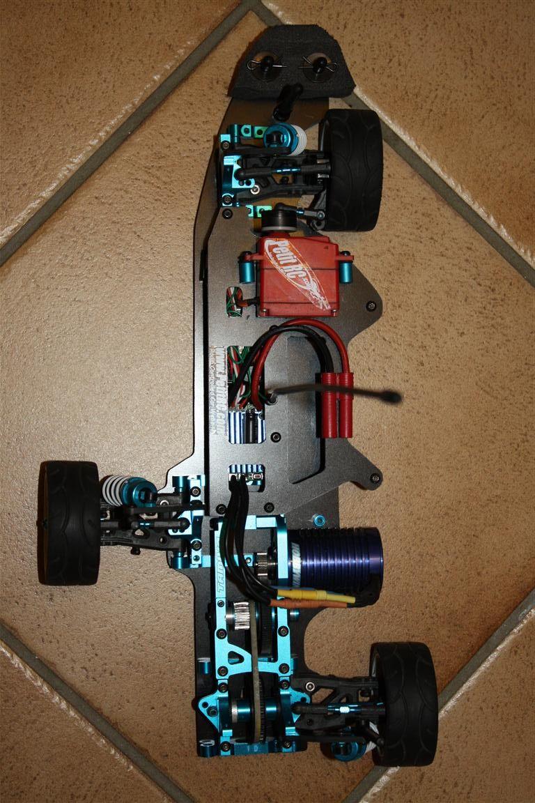

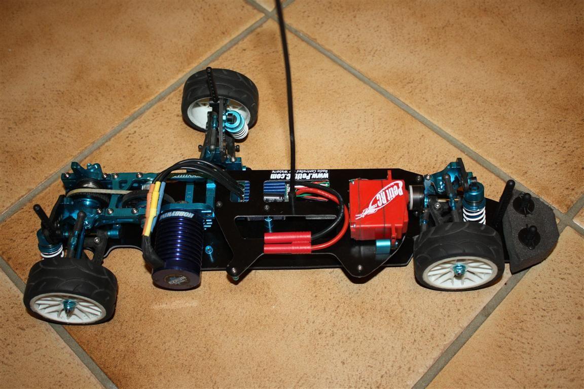

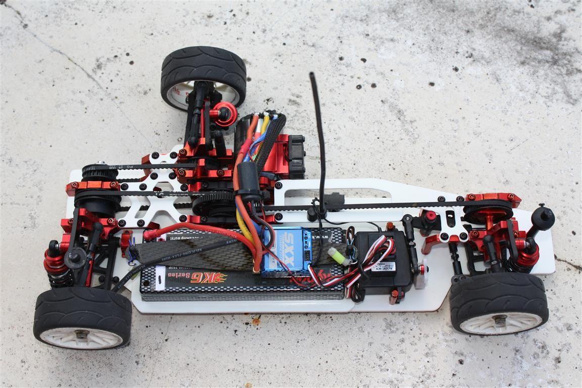

The photos are gone. here my 3wd sidecar:
calimerosf501 is offline
Old 05-03-2019, 04:47 AM
  #42
Join Date: Dec 2008
Posts: 83

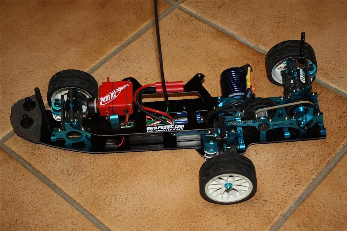

since most of the photos are gone I put them here again

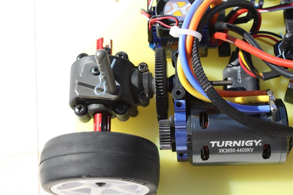

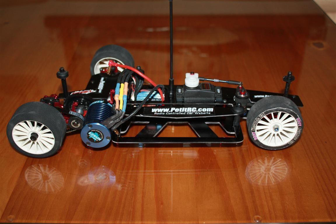

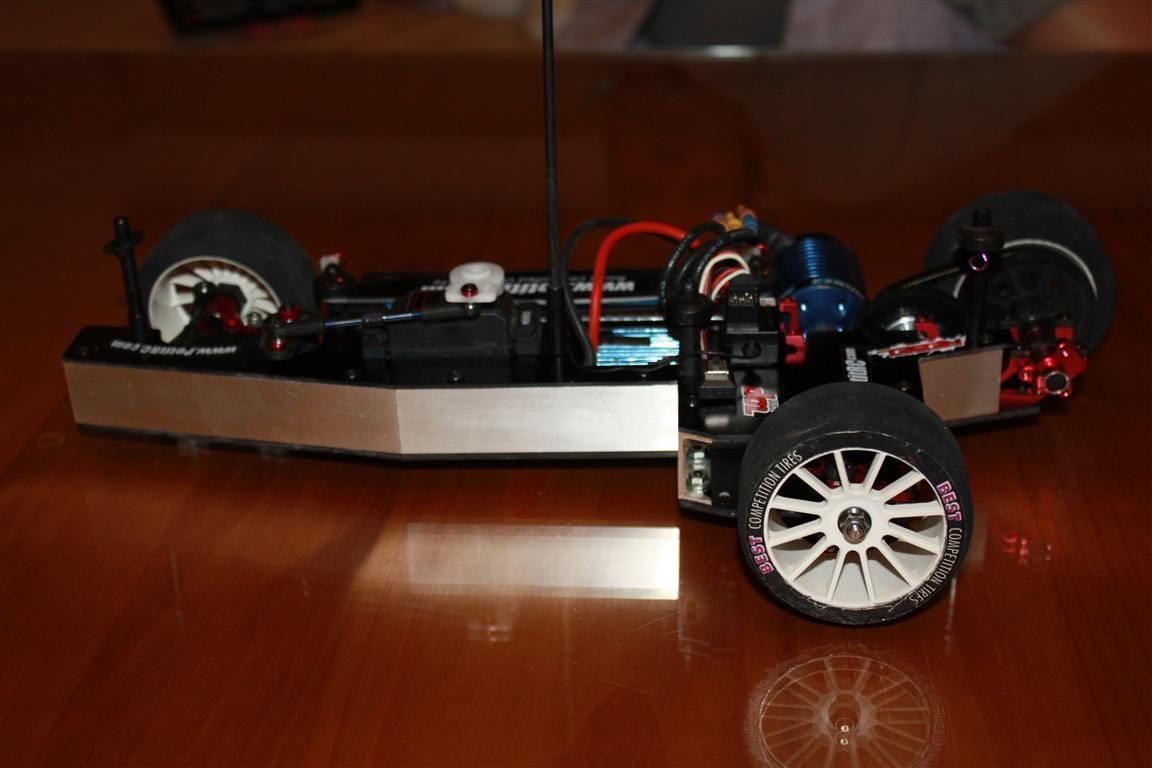

My first 1WD with DTM wheel, rubber or foam, for choice:
Old 05-03-2019, 05:10 AM
  #44
Join Date: Dec 2008
Posts: 83

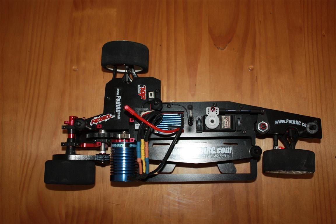

an other for a friend:
Old 05-03-2019, 05:13 AM
  #45
Join Date: Dec 2008
Posts: 83
Mine for French championship:
