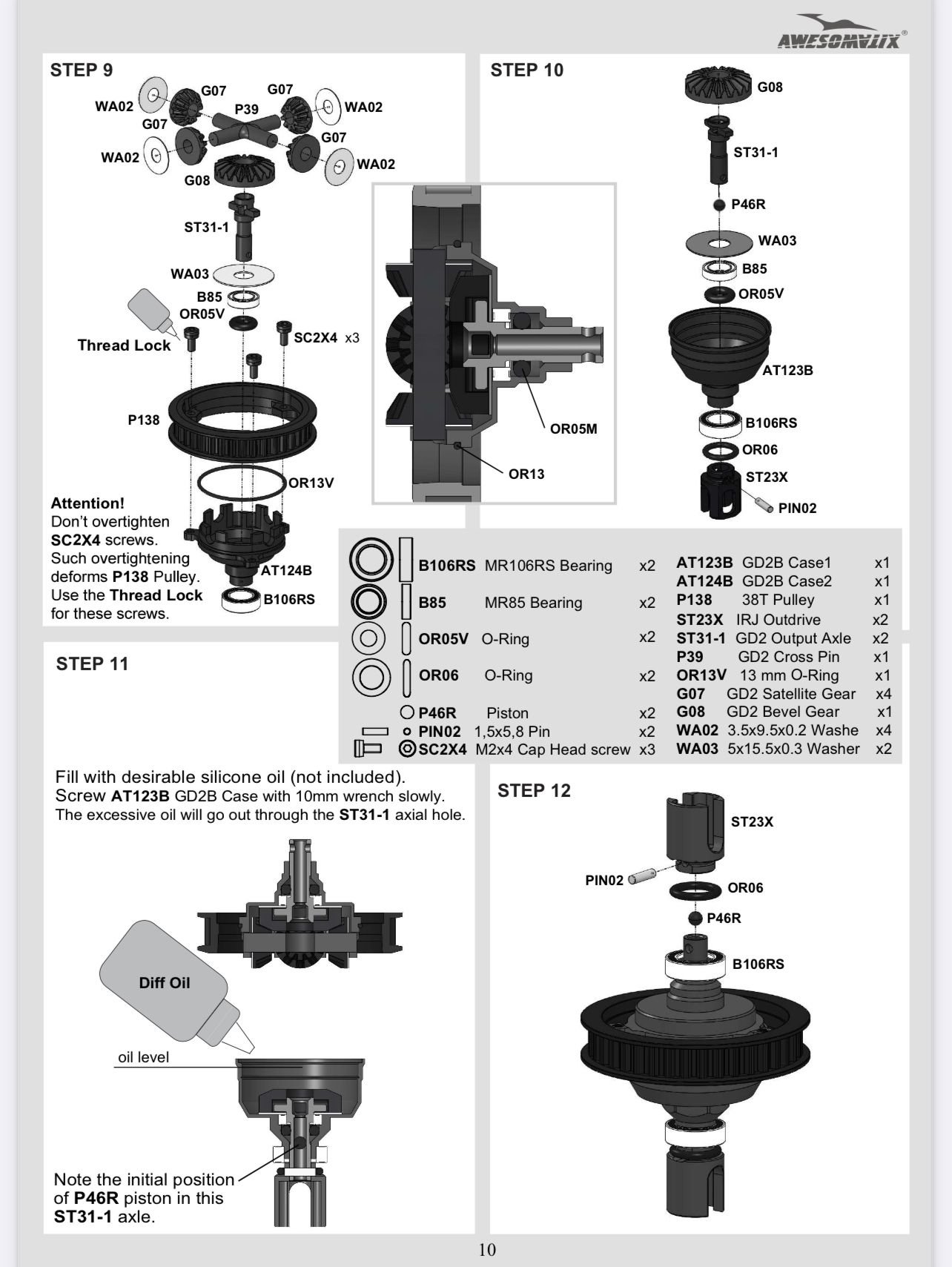

Originally Posted by phatboislim View Post
I would think id need thicker not thinner shims seeing as tho im abnormally shredding gears. But yes, overall that is my procedure of rebuilding the diff aside from the p46r ball. I've never had that in my diff since I've this diff. This is how I've been building mine parts wise
If you're running the kit "big" shim it is .3mm thick.
If you're running the "small" shim it is .4mm thick.
If you run the small shims with .3mm thickness at some point you'll eat the gears.

When you say big you mean the diameter I'm assuming. I'm going to make a order today. If it shreds again I'll just make it my stock car again

Well...got the diff back together with the smaller diameter. .4mm shims. Hopefully it wont shred on me this weekend...if it does im putting a 21.5 in it with the shorter arms and run that. Cant shred with a spec class.

Guess I'll try both shims together since the diff didn't engage at all now. Never dealt with this kind of nonsense on a diff before. I have to attribute it to mod, but then again I'm the only one with the issue
there are 4 planetary gears, they have shims behind them. Also there are two large shims, one behind each of the two large gears. Wondering if you forgot the 4 shims , one behind each planetary gear ?

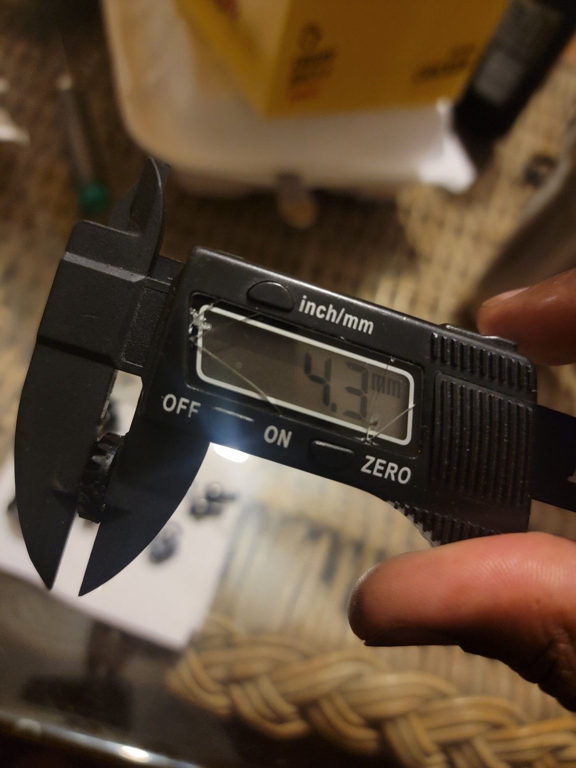

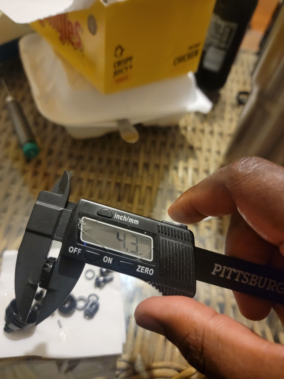

Please measure thickness of two big G08 gears.
We still don't have this info from you.
There are two versions of these gears:
G08-3.95 ~3,95mm thick and not suitable for this diff.
G08 ~4,35mm thick and suitable for this diff.
glennhl likes this.

If you are running the correct 4,35mm thick G08 gears, then there is only one other thing I can imagine would cause the gears not to engage. What if you cross threaded the diff housings and they aren't getting screwed down all the way? Maybe there is a measurement you can take on the outside of the diff housing to confirm the housings halves are seated all the way.
