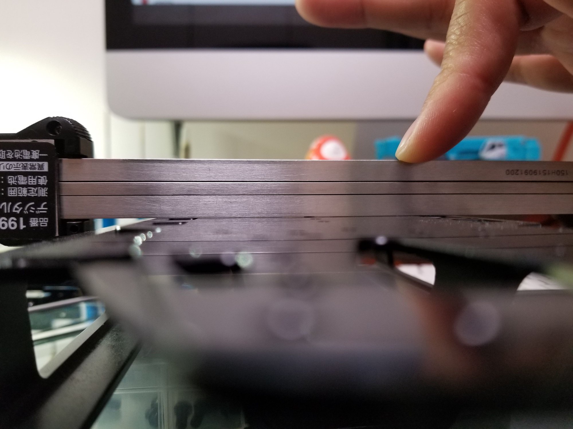

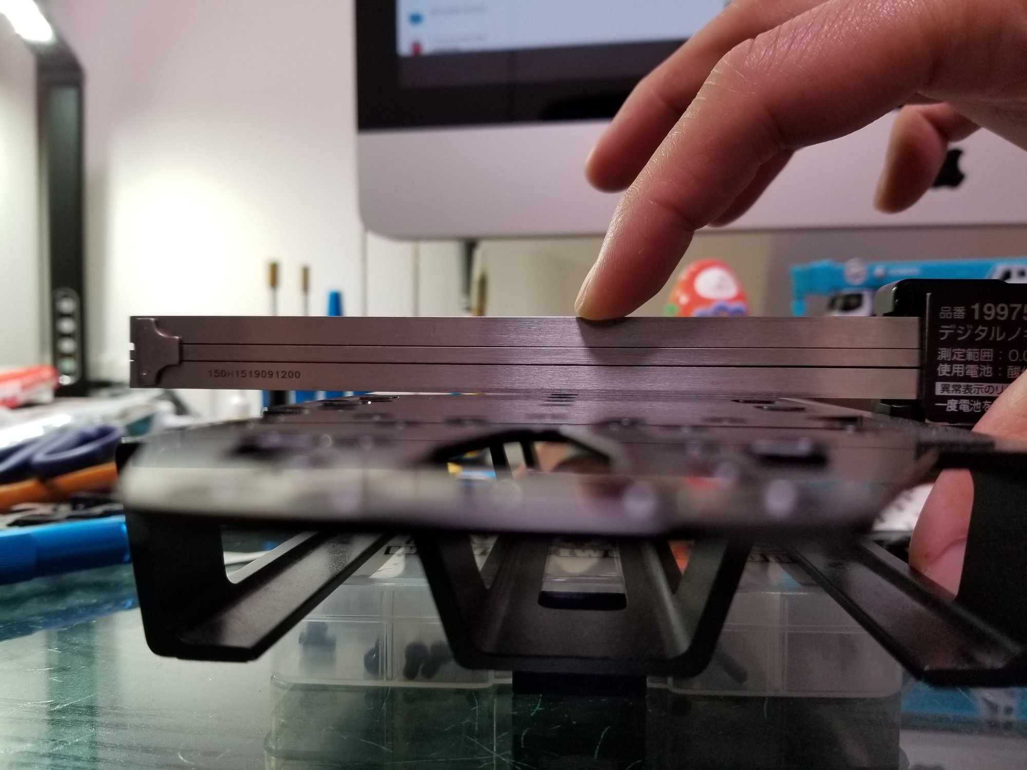

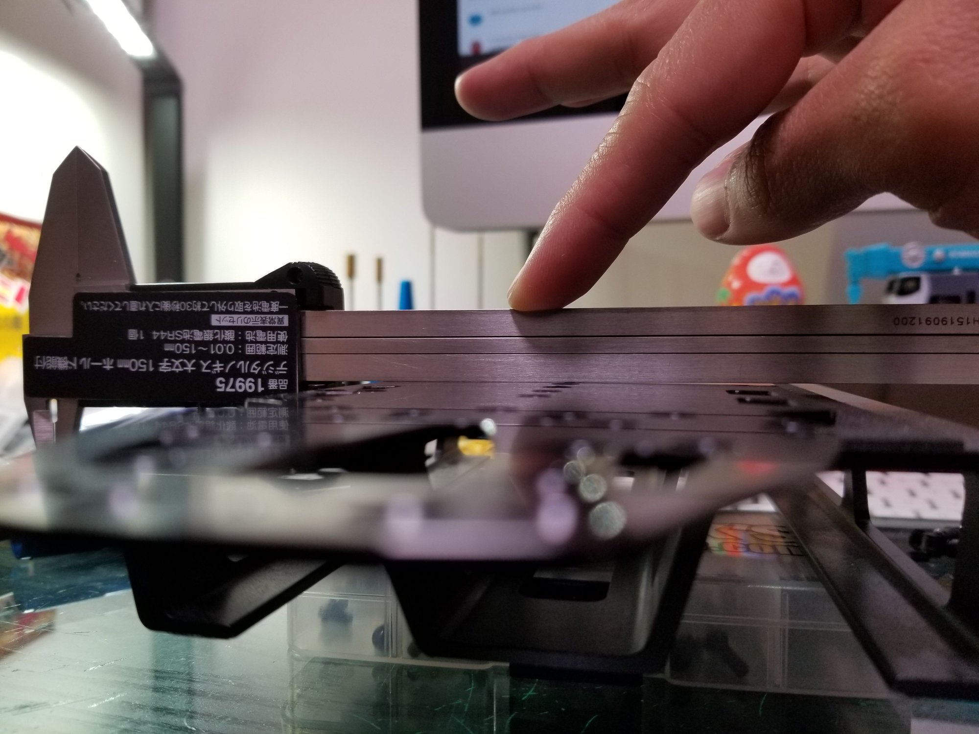

Just in the process of building my A800MMXA at the moment, so far I've mounted the front/rear bulkheads and the motor mount on the chassis plate (no top deck mounted yet).
I noticed that the chassis seemed to lift about the longitudinal axis when I press along the edges (the opposite side would lift up), as if it was not flat. I thought it was the bulkheads/motor mount that was binding the chassis (I used a bulkhead alignment block, maybe not necessary, and I suspected that maybe the chassis was bent by misaligned screws forcing against it), so it started removing the parts piece by piece and it was the same by the time all parts were removed from the chassis. I was almost sure that I might have deformed the chassis by using the bulkhead alignment block, and I remember checking the chassis plate on glass at first and it was flat (forgot which side it was).
However when I flipped the chassis over with its top side (non countersunk side) facing the glass, it was flat
Then doing a search on this thread I came across this post by Oleg. Checking with a straight edge against my chassis plate, it had a noticeable transverse convex shape on the bottom side and a slight concave on the top side, which is opposite to his post.
Are the current chassis still manufactured this way?
I was about to order myself a new chassis plate , or maybe I do have a now deformed chassis? Anybody notice this?
Bottom side, convex, left
Bottom side, convex, right
Top side, barely concave

Nothing to worry about.
We mentioned already in many areas that its close to impossible to produce 100% flat 2mm thick true 7075 T6 alloy chassis plates with milled areas on one of side. With EVERY hole, cut out and/or countersunk you deform the material structure.
Others alloy types (6061 or 2024 that very often are used under name of 7075 alloy....) can be flat during other material properties.
The latest step in a chassis production is the "straightening", because the raw plate is always bent after milling and cutting.
Like always and everywhere there are tolerances. Chassis which aren't inside the given tolerances, will be not find the way to a customer.
Additional info:
You will note that once you installed all parts of the car (bulkheads, motomounts, topdeck's, dampers and and and....) the flatness is good.
Chassis with bulkheads installed and not topdecks = never flat IMO.

Thanks for clearing that up for me.

That was a great answer. Mine isnt flat either. It doesnt cause any problems so i left it alone.
