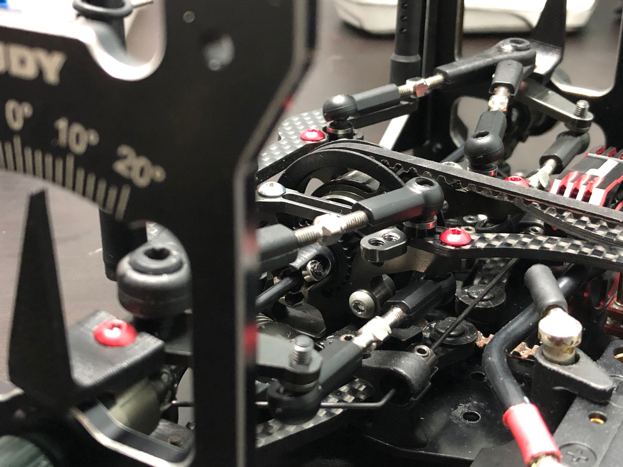

Noticed that there is trend in the Mid Motor Cars to use the AM19-2 vs the AM19-4X in the rear (usually in wide position on STD LA A800x) can any one shed some light this reasoning?
AM19-4X was good with normal arms.
New long arms ( LA set) need a bit longer top links. AM19-2 provide this.
I recommend to try LA without any AM19 with top balls installed directly on top deck and on bulkheads.
P22 bars should be use at thus for holding of spool and diff.
We have tried this only on ETS carpet and AM19-2 was better. But maybe at others conditions (on CRC carpet for example) "non-AM19" variant can be better.
Thanks Oleg for the informative response...What about running on asphalt?
Asphalt tracks and conditions are so different around the world. Still plenty of combinations for tests.
I think the extra long top links ( without AM19) in conjunction with LA set can be good at extra low grip and at extra high grip conditions.
Really need to get some 38-40mm turnbuckles but I can run one of them longer while having enough thread in the plastic to hold up for a light crash... Maybe...

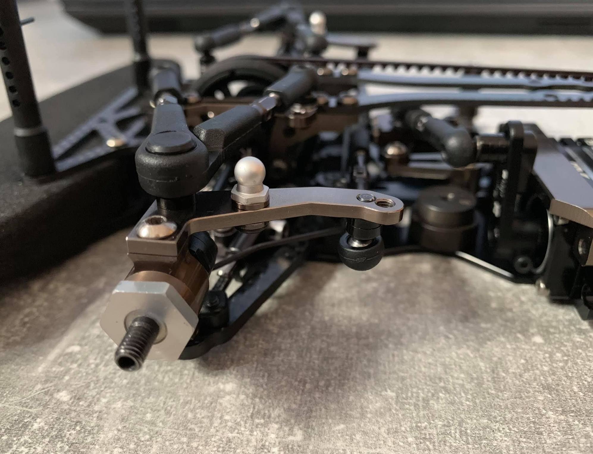

Please pay attention on this tip to extend the reliability of ST38 and AM14LS on tracks with hard boards, which are common in US.
AT21 or AT21S on top will be an steering limiter in crash situations.

Xtra long upper links was definitely better on low grip black rug with the LA MMCX. Thanks Oleg.
