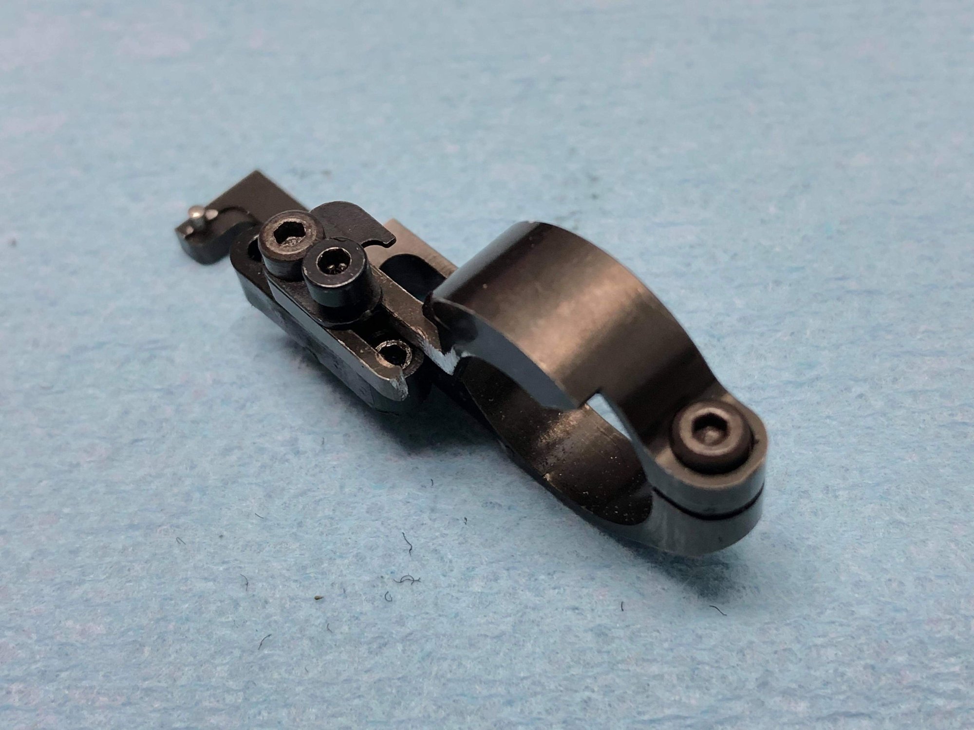

Originally Posted by trilerian View Post
It is kind of a pain to setup. Slide the hook all the way out, then adjust the set screw down. Move the hook back to your normal position to measure pss height. Rinse and repeat until you get the correct height, then adjust ride height screw to your race height. Also I had to use an l wrench instead of a driver because the tip on the driver wasn't long enough.
cut the am17 so you can access the screw and not have to slide it
iTz Nicholas72 likes this.

Posts: 1,975
Trader Rating: 19 (100%+)
Kodey65 likes this.

Originally Posted by iTz Nicholas72 View Post
wow....that would make it much easier for sure.
