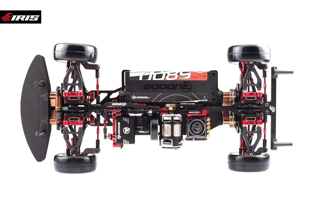

Originally Posted by WayneKerr View Post
https://imgur.com/a/G7Vebm5
the front counterpart is behind the bumper. the coilover unit is the heave damper.
was really hoping someone would be gutsy enough to try a mode decoupling solution
for the life of me I can't think of a good reason why they chose that placement for rear toe link.
I'm reserving judgement until getting a closer look...Myrberg has shown over the years that he has a good head on his shoulders...
i don't know rc designers. but i am excited someone decided to use real world solutions and bringing em to the 1/10 world.

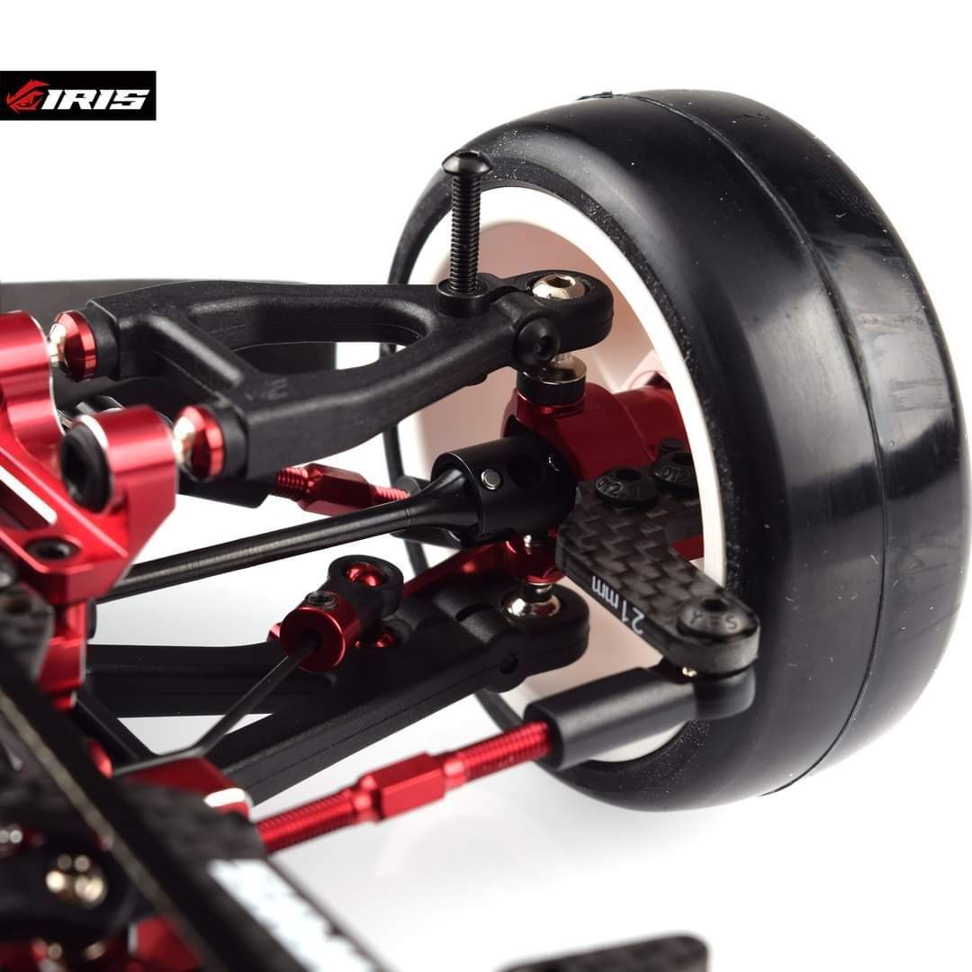

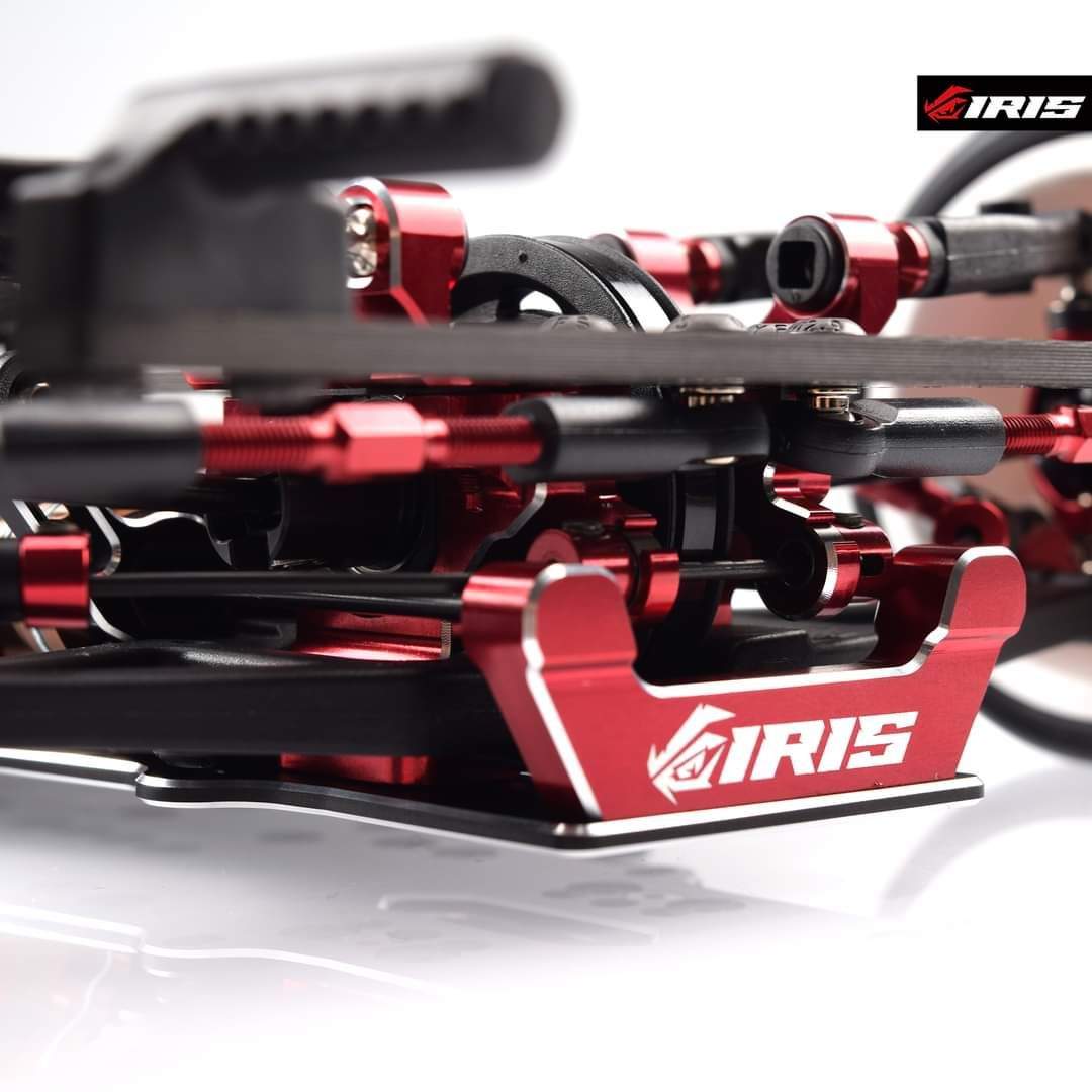

People say the Awesomatix is overly complicated. Once you're familiar with the design, it's a simple car to work through, adjust and maintain. I doubt the Iris is any different. It will have a learning curve, but unless there's something bizarre inside the dampers or diff, I doubt it's any more difficult than the Awesomatix.
I'm curious what the benefit is of the front pitch spring/damper. I thought 1:1 cars use it to keep the car from bottoming out at high speeds with large amounts of downforce. Maybe it's a good way to tune initial corner entry.
Chassis flex looks interesting. It seems like the back is going to be pretty stiff with the short rear top deck and no lower cutouts, and the front pretty soft. But it's hard to tell without seeing the car in person.
Is there a benefit to mounting the upper arm inner pivot balls horizontally? It seems like the Awesomatix upper arms are more simple and effective.
If lower too (cant see yet): Track width adjustability?
Yeah it´s the easiest place to mount it, they often did not even need a new Hole
Look at Schumacher Axis or SST2000 they have them also in the back and I raced this car with no issue

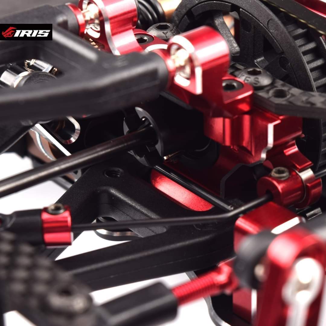

I wonder how u adjust caster ?
Looks like you can shim the length of the ball studs connecting the arm to the bulkhead to change the angle.

I've got a feeling there's going to be different top plates to change caster . Like how mugen does it
If this is the case then I think IMO they kind of dropped the ball on the design. Unscrewing the ball stud completely off then adding or removing a shim, then put everything back together, put the car back in the setup station, then do it all over again if that shim isnt enough just isnt ideal. Also you are at the mercy of how thick or thin of a shim you have available to make this adjustment, and even then its still a stepped adjustment.
Ideally I think they just simply screw the ball stud in or out for both camber and caster adjustment. for fast and easy adjustments
