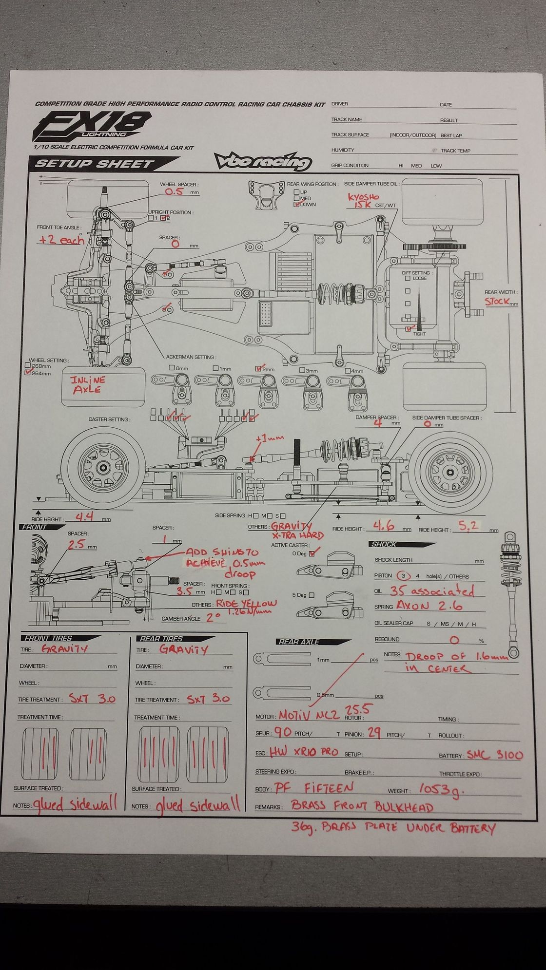

My car, the one that made TQ
eevul, Tim Neja and Holmestead like this.
