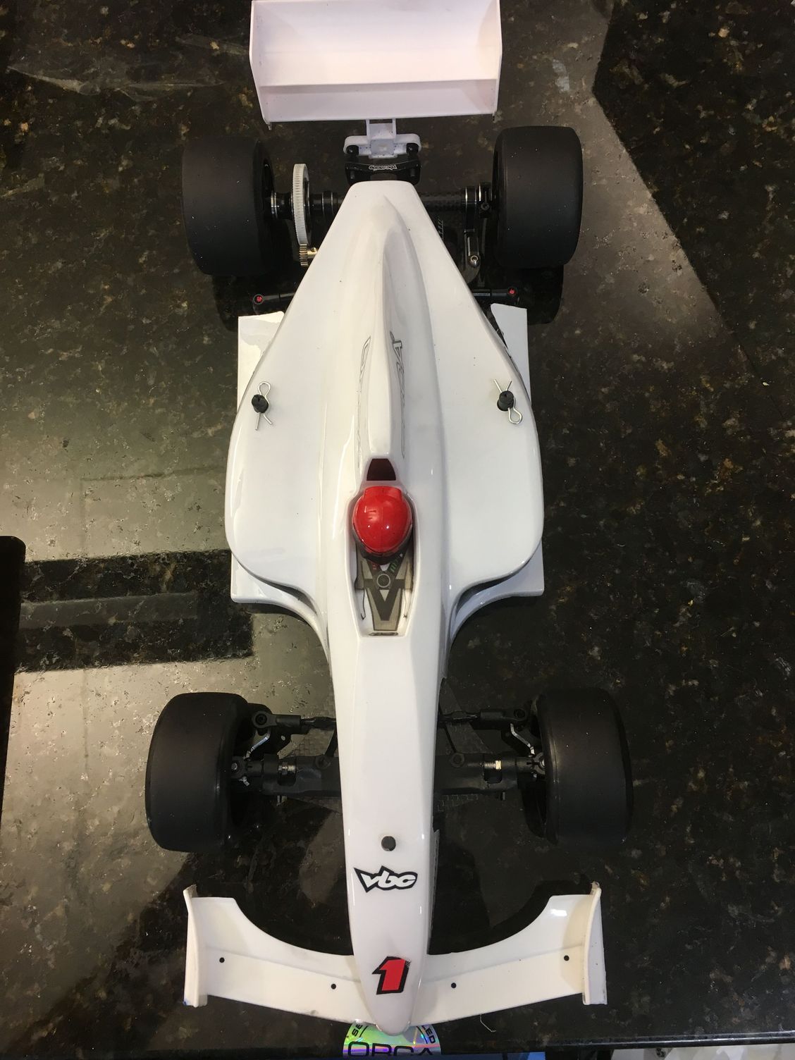

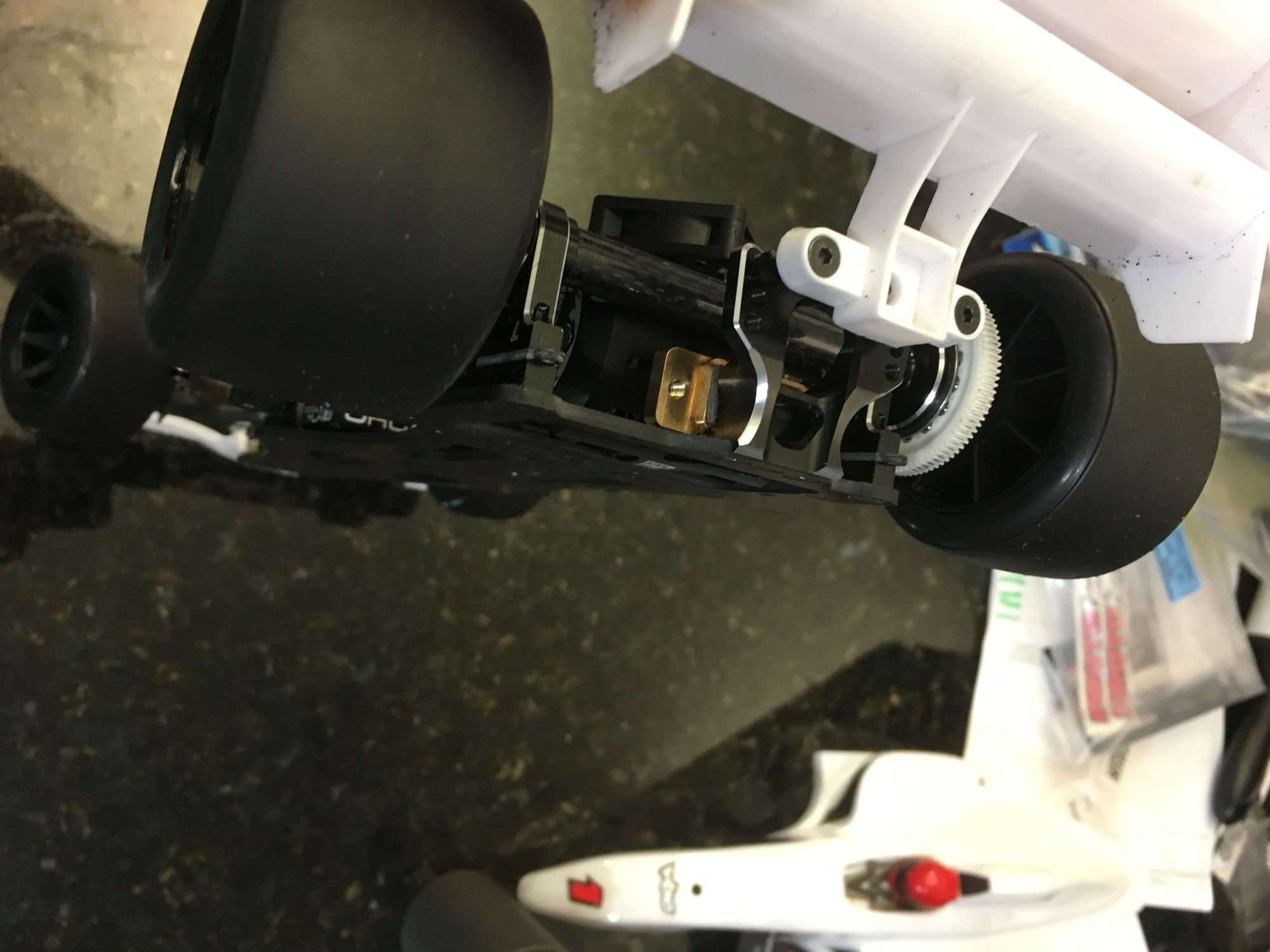

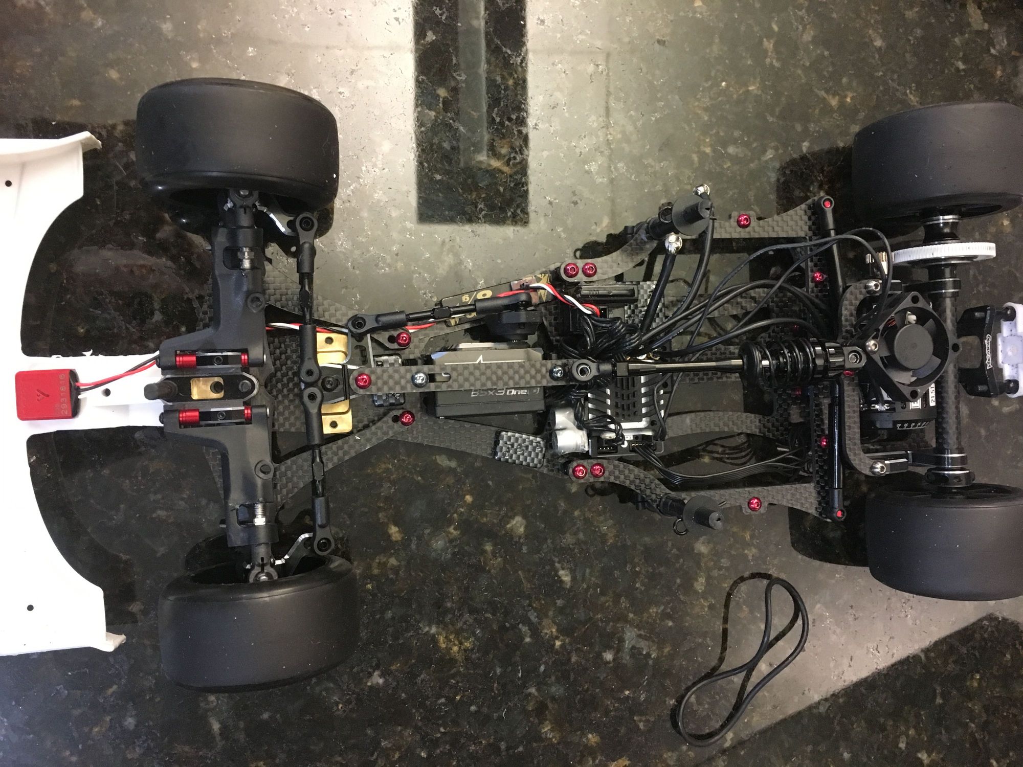

Pictures of my car.
Fan was a late addition hence the mess of wires.
Montech f17 body
2017 montech wing (Ferrari f60 wing offers best balance so far) montech wing has worked in the past on high grip asphalt. Basically any time your looking for steering.
Battery is reedy zapper 4000 150 grams (orca does not have lcg shorty yet)
Esc orca b32
Motor orca blitreme 21.5
Servo ko grasper (will change with mks when I sell grasper)
Tires shimizu 571/572
