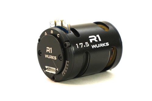

Been running a stock 17.5 D4 in 1/12th for the past month and switched to the R1 Wurks today. WOW what a difference... The D4 was ok but just couldn't get the speed out of it. The R1 has much more torque in the infield and greater top speed. What most don't know is there are several versions of the D4 and prices vary.. R1 has one model and its fast out of the package!!
http://www.tqrcracing.com/shop/produ....asp?p_id=8762
