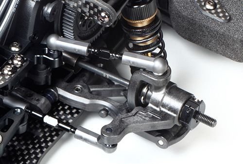

I saw it in pictures that the black edition didn't have aluminum suspension mount (blocks) but rather using plastic while the FF04 Evo (blue) uses aluminum. It this correct?
As seen here:
Nicadrauspro4 is offline
Old 11-18-2019, 07:17 AM
  #253
Join Date: Sep 2010
Location: Chicagoland
Posts: 2,175
Yeah, the suspension mount blocks are plastic.
