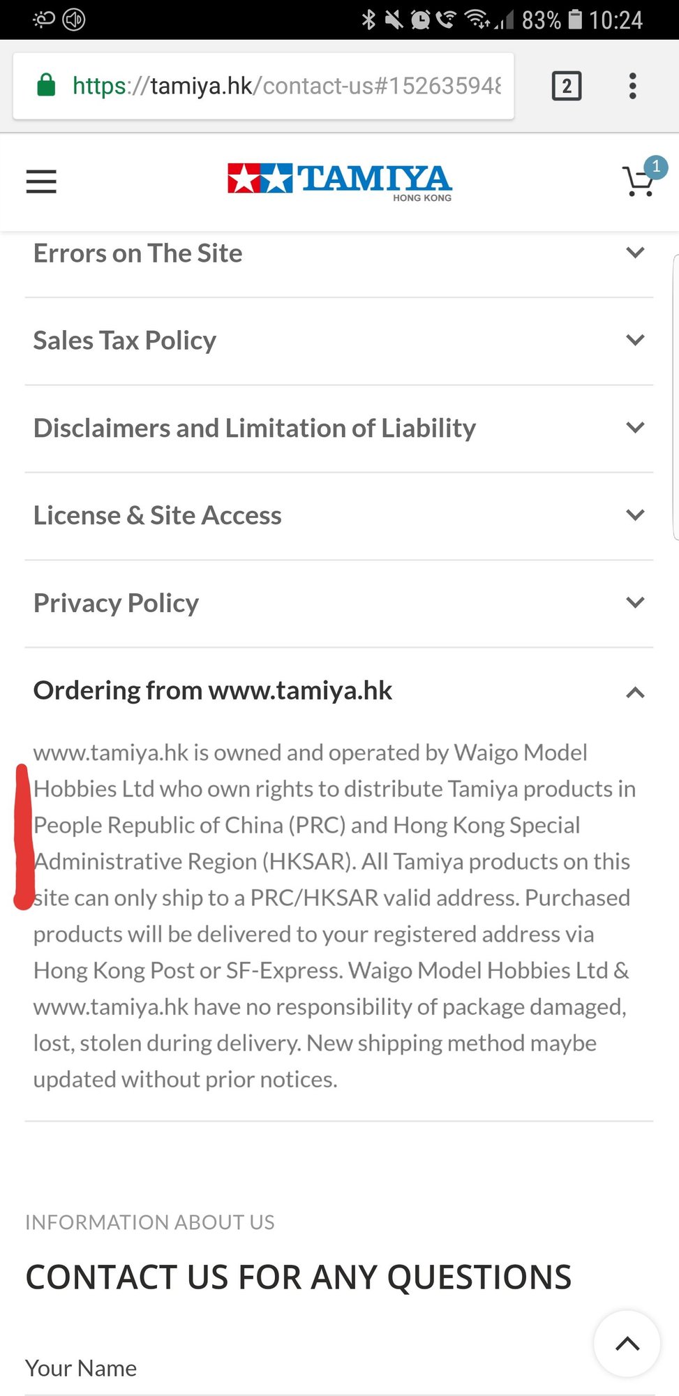

Restricted! They have the new TB05 aluminium diff housing in stock. No chance to get them to Germany...
That's Waigo (Tamiya.hk), they clearly state, they have the 'right' from Tamiya to sell only in HK and Mainland China...
