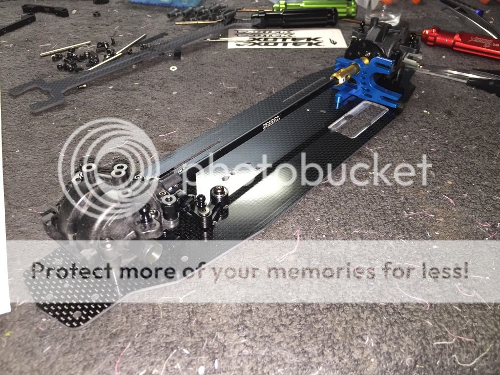

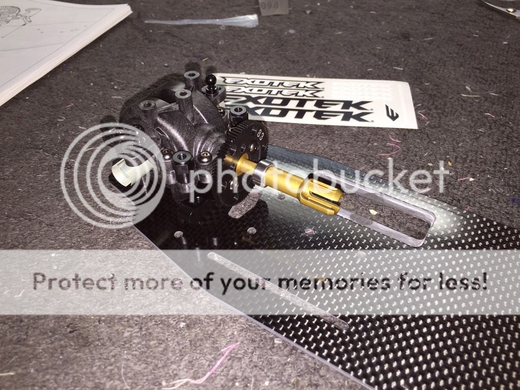

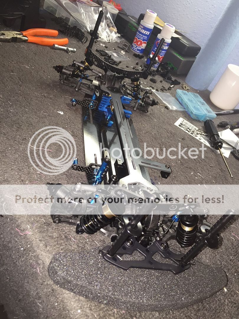

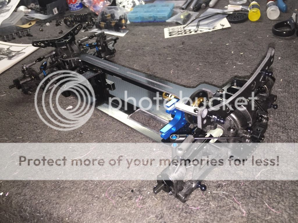

Just finished building my kit. It was the first Tamiya I have owned since my Frog in the mid/late 80's. The car went together great. I really like how the gear diff was done. I am running the EXO SIX conversion as well. It went together great. The spur adaptor is awesome and the battery hold down system is down right ingenious.
In the last pic, I used a bumper mount from my VBC D06 since they match the Tamiya perfectly and provide a brace as it is just right to touch the sway bar mounting screws.
Now I just need to swap over the electronics from my belt drive cars and get in some track time. Going to try RobK's suggestions for a starting point on carpet.
Here are a couple build pics.
