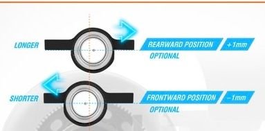

Does anyone know if this will fit the older car.
XRAY 2.5mm X1 2019 Graphite Rear Brace - XRA371078
Thanks

Heads up, if you get this option part, it has troubles for carpet racing. If you bang a wall just a little bit, it wont break or bend, but it will loosen the left wheel off the axle every time. This is due to that the short and long wheel base parts do not have the plastic ring for the bearing like the middle wheel base

Good to know, saved me some money. (Actually, I'm not good enough of a driver to tell a 1mm difference in wheelbase.)
