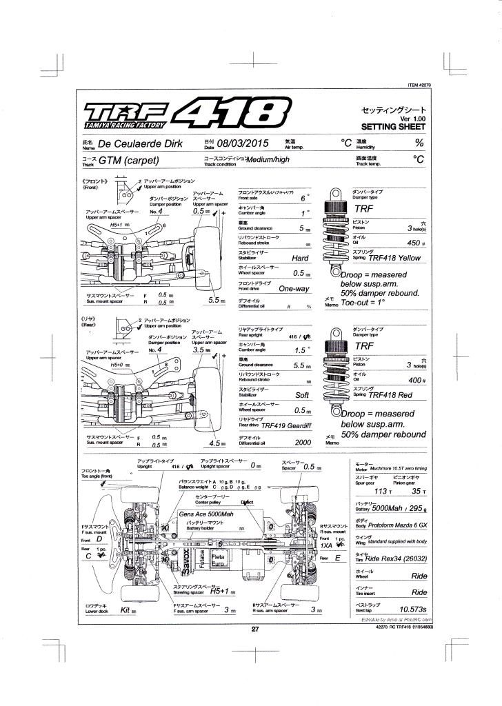

Below is my setup.

Wow. You're running a front oneway.
yep
addicted2blue is offline

wow 1 way... haven't driven on in like 10yrs... with a 10.5t??
This is something ill prob not try lol...
For our nationals we are not allowed to use boosted or motor timing + we have a minimum FDR of 5.8 (indoor) and 5.4 (outdoor). This is ofcourse with only a muchmore fleta euro ESC + motor with zero timing.
The one-way suits my driving cause i don't use brakes, only drag brak.
Modified was only a few tenths faster then us.

Good on you for doing it. How's your consistency?
With that setup I would guess you have some really slow corners and lots of grip, so the oneway might help pulling out.
Drag brake will still only work on the rear and if too much it will still spin your car around.
There were a few slow corners and lots of grip, some guys had traction rolls.
My drag brake was set at 10%.
