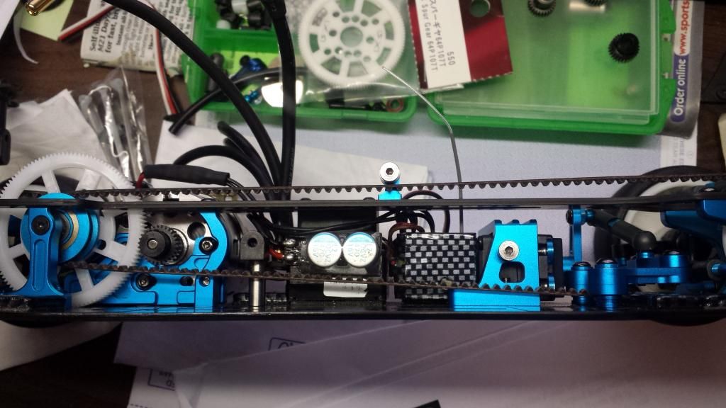

Another question concerning battery stops.
The car comes with a front, rear and a sidestopper on the servo mount to support the front of the battery. But I would like one to the rear also to prevent the battery touching the belt.
I have read some recommending a 630 bearing, but I cannot find any pictures and can't see where to mount such to act as a battery stopper. Can anyone please explain where to fit the bearing?
Or are there other solutions?

Easiest solution is to either...
- mount the whole belt tensioner in the spare hole in front of the motor mount
- mount just the bearings and hardware from the tensioner in the front of the motor mount in the spare thread.

My rear lipo stopper / tensioner is a couple of 630 bearings and shims (built same as top deck stopper.
See below.

Ps - my spur gear is seriously dirty!
No wonder the factory ones are black, hides the dirt
