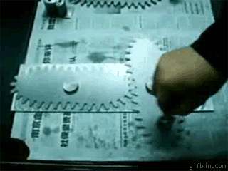

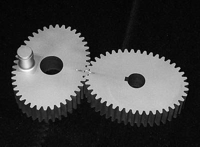

This thread is exactly why I like to run a non-circular pinion/spur combination.
I get the best of everything!
My gear ratio is all over the place, my temps are hot and cool, the amp draw is high and low, the output shaft moment arm is always changing, and I'm speeding up and slowing down whether I like it or not. It throws that 0.06 thing out the window and makes my crappy driving skills irrelevant. Who even cares about rotating mass at this point? It's less stress and I sleep better!
Problem solved.
You guys can thank me later. :-)
glennhl and RCSteveH like this.
