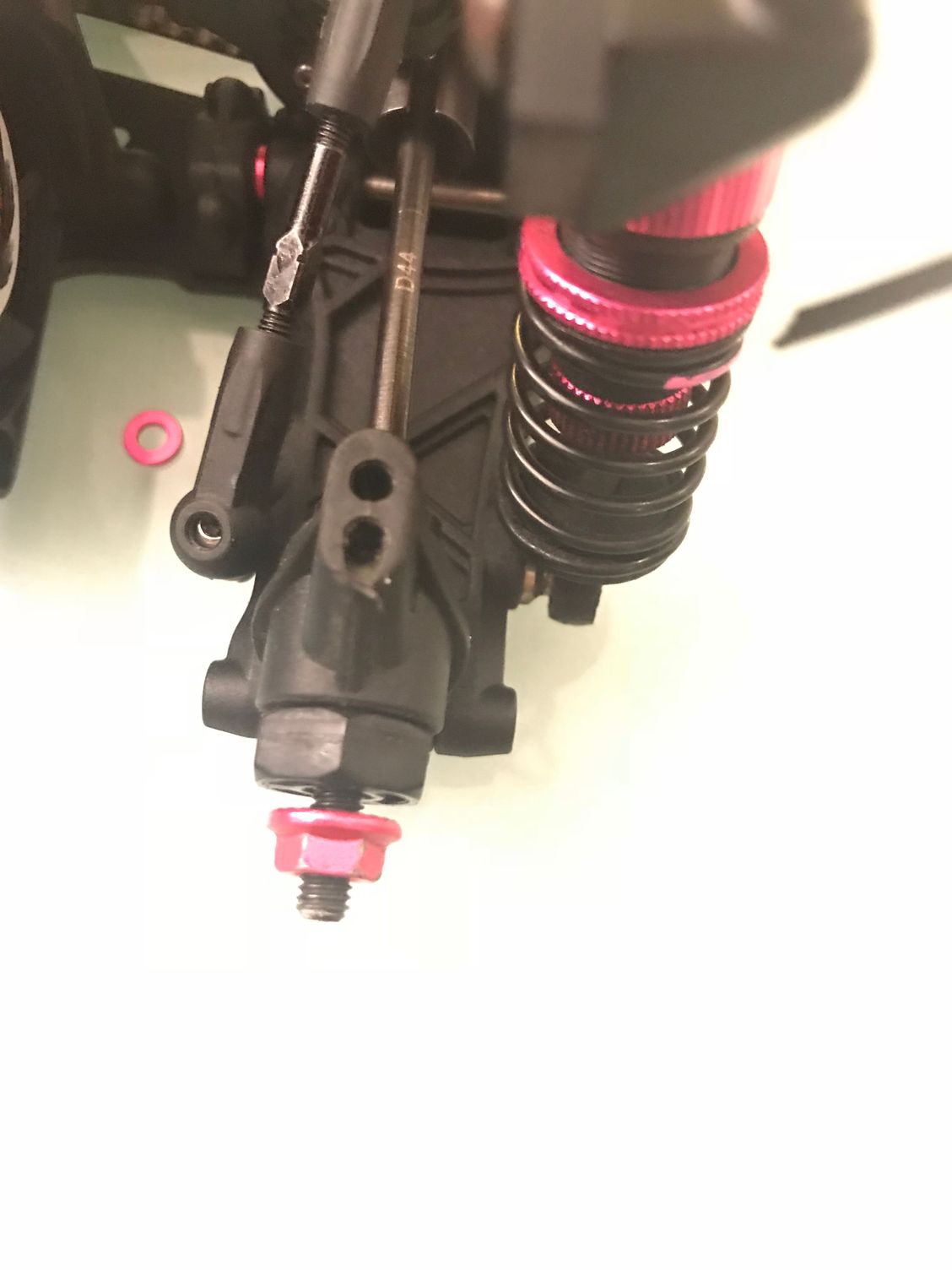

Originally Posted by julieng View Post
Sure I will post it tonight. I had the same issue with 3Racing and Turnigy parts. So we have broken 4 of them.
Here is the picture of one of my broken hub thread
Any idea of the root cause?
For next week end, I will use the inner position. What's the impact on the car handling?
Thanks

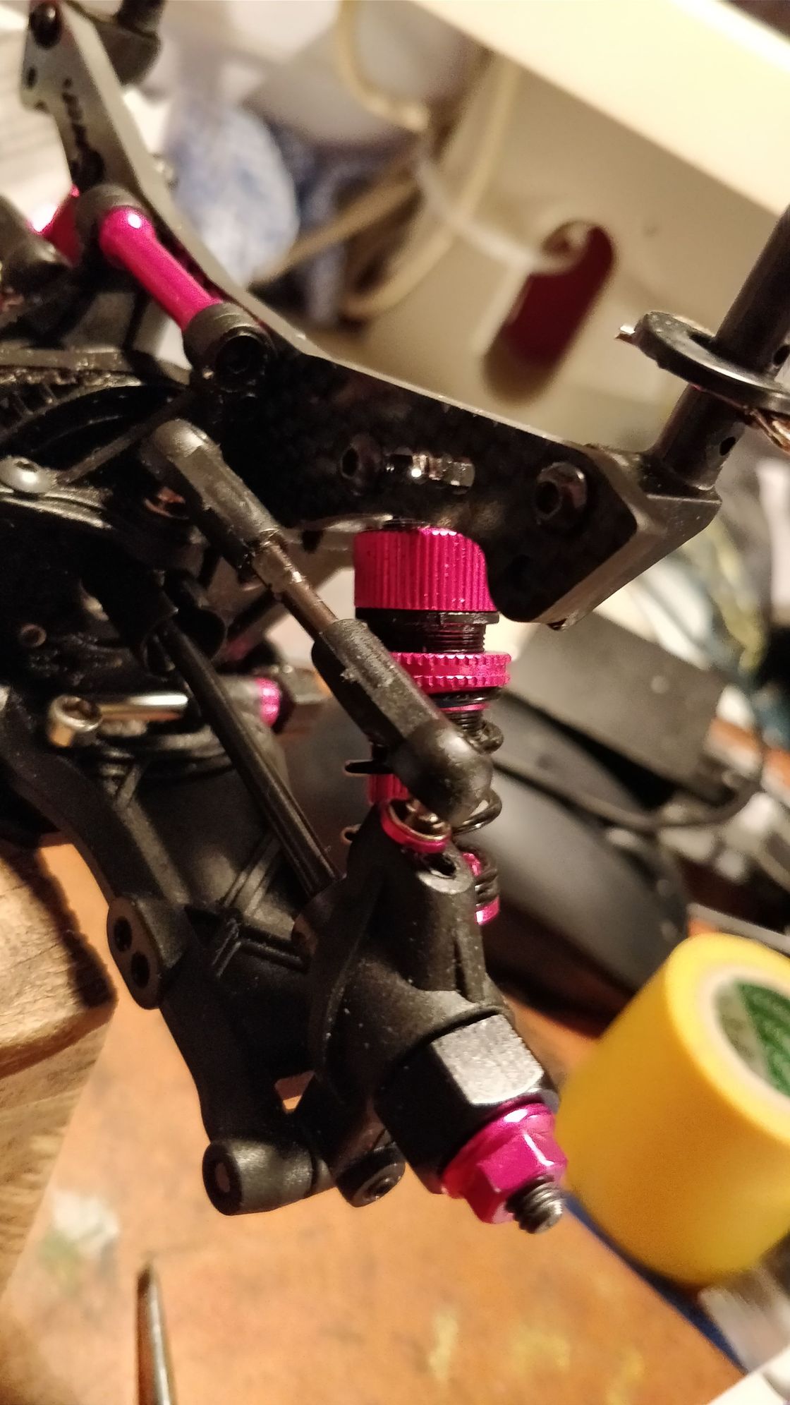

Just to be clear you are using the stock ball stud right? It measures 5mm long on the thread and even with a 1mm shim is plenty to hold onto the hub. I am also running a 1mm shim on my rear outer hole still on the stock kit hub, I have the spare composite ones too as backups. Are you having any other vibrations or loose fitting components in the rear such as wobbling hub on the hinge pins or excess slop on the arms causing vibrations? I use a drop or 2 of blue medium thread lock on mine just to be safe.

Thread lock into plastics? That usually hurts more than it helps (it has the tendency to soften some kinds of plastic) - I do not recommend that in general.
Haven't had any issues on any of my cars yet. Been doin that for almost 5 years.
No vibration. The screw were not loose and not over tightened (2 fingers approach to screw)

But, as much as I think it's generally not a very good idea, just as I said earlier, I also don't see it being very useful either (no offense). Unlike screws that go into metal (where you have almost zero resistance in turning the screw until you hit the end of the thread), putting screws into plastic usually offers quite a lot of resistance to turning the screw form the material itself - all the way in, not just at the very end. And they take quite a bit of force on the screwdriver to get in all the way (compared to metal). Usually that's what keeps them in - securely. With the exception of some screws holding dampers in arms, I've rarely seen screws into plastic that have just come loose somehow, without being ripped out or the plastic part being at least damaged or destroyed (in which case thread lock would not help either).
