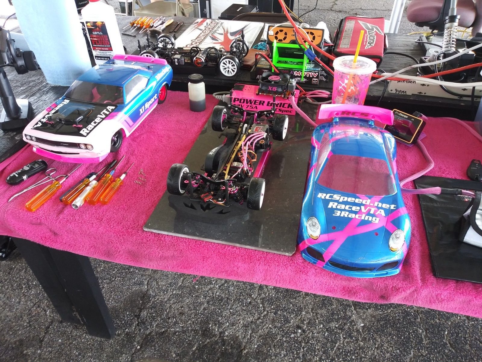

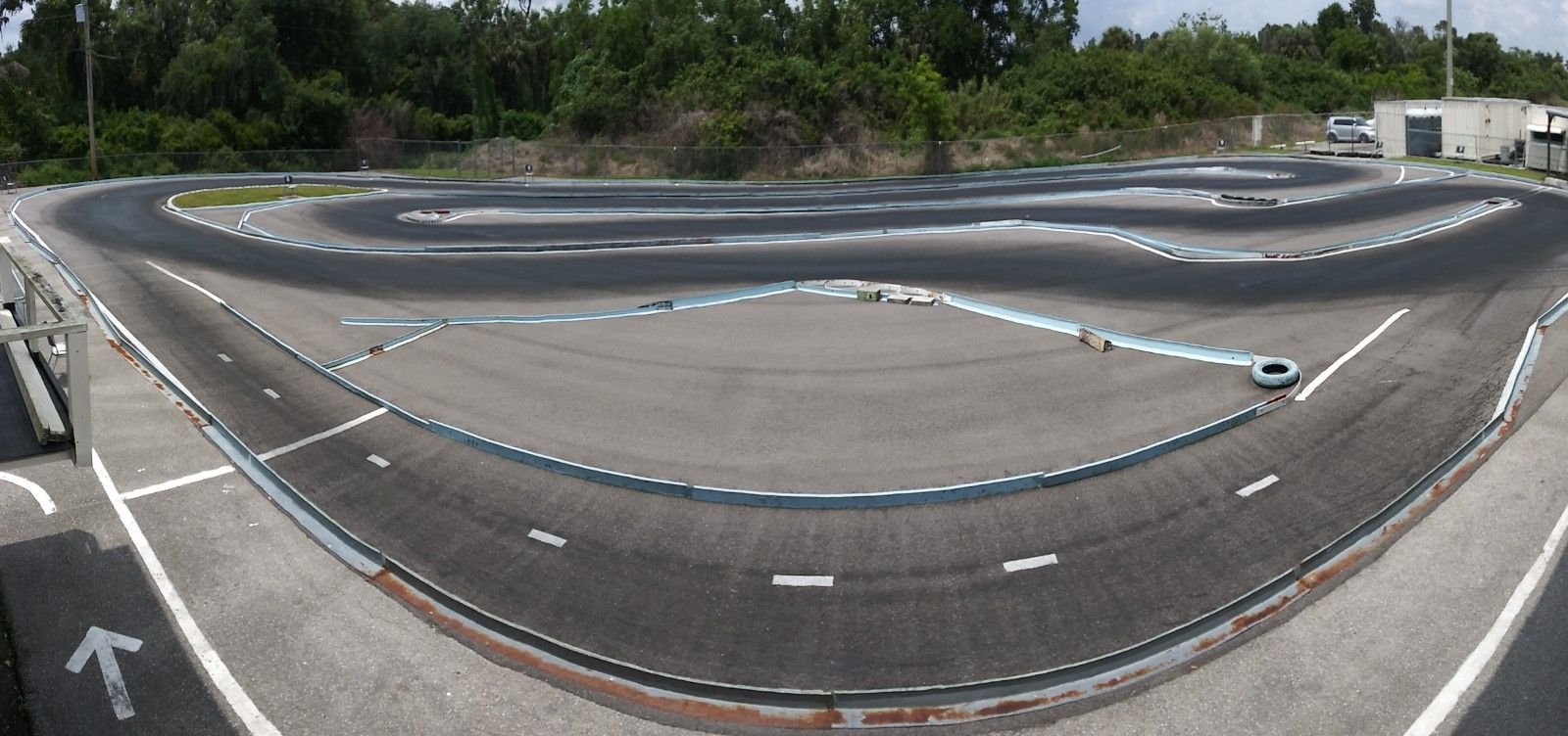

Had our last Florida State Series asphalt race of the 18-19 season, ran some usgt at The Fort ... home of the Winternats, beautiful track without any straights (bean shaped track) ... everything has a curve to it, takes a while to figure it out
Traction was unbelievable, rear traction was not a problem here as long as you stayed in the grove, got 3 rounds of qualifying in before mother nature ruined the show ... yep it rains in florida, sometimes
Despite the metal barriers and some hard hits nothing broken, had to visit the set-up board several times

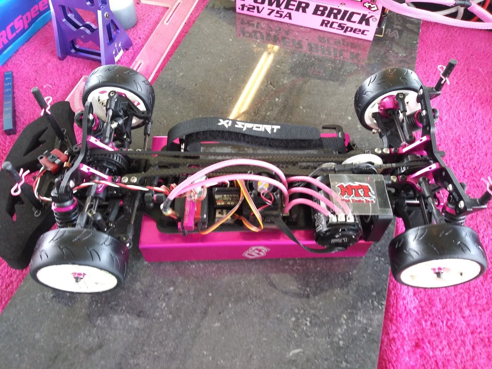

Thinking of getting a XI Ver Nu. Which upgrades from the previous sakuras are compatible with it? Thinking of blinging it out in pink aluminium
s10096898 is offline
Just about everything from the ultimate will fit except chassis, bulkheads, motor mount and outer suspension mounts ... 3racing makes these different for every model change, everything else is compatible.
The motor mount, bulkheads and ouiter suspension mounts are available for the XI in pink
