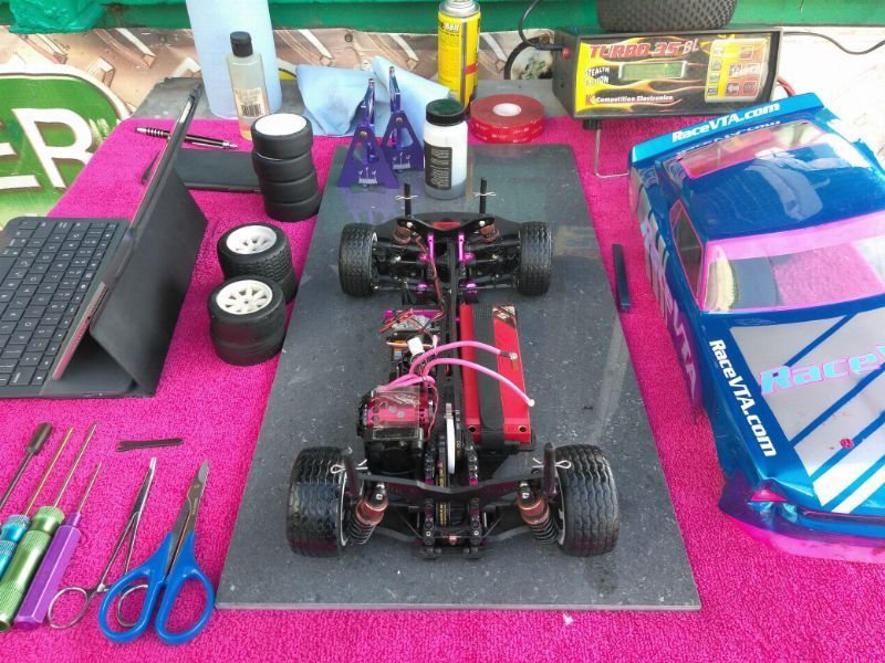

Had some fun racing VTA oval on asphalt last night, changed the setup a bit, close but not there yet, rear end felt a little more loose then I wanted. Finished 3rd on the same lap but had issues with a loaner i-lap transponder so ordered a new one to use just at that track ... guess not all tracks run amb
Front shocks 32.5wt oil, rear 30wt oil, stock pink springs
3* rear toe in, short rear upper link with 2mm spacer on hub, 1k diff, everything else left the same from my carpet setup.
For next week will lose the rear sway bar and go to a softer rear spring, might also try shortening the rear wheelbase.
Open tire rule, was the only one on protoforms lol 1st place had HPI vta, 2nd was running TC tires ... next week will try some hpi tires.
