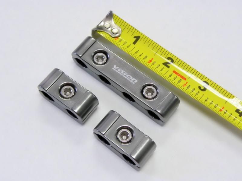

Those look like spark plug wire separators. You can pick them up at your local auto parts store. Just extra weight IMO. And like the others have posted, you want small wire for the motor.
def not spark plug separators. I got them from a friend and he doesnt remember where he got it.
sux that i only have 2. also, spark plug separators are gigantic.
doesnt hurt to try i guess.

That is a good looking car. Where did you find those wire separators? That is pretty trick.
Active Hobby make them:
http://banzaihobby.com/index.php?mai...pto=&x=23&y=21

THATS what it say on it... ACTIVE.... Geeez it is so small that i couldnt read it. lol
i got get me more.... sold out in blue tho

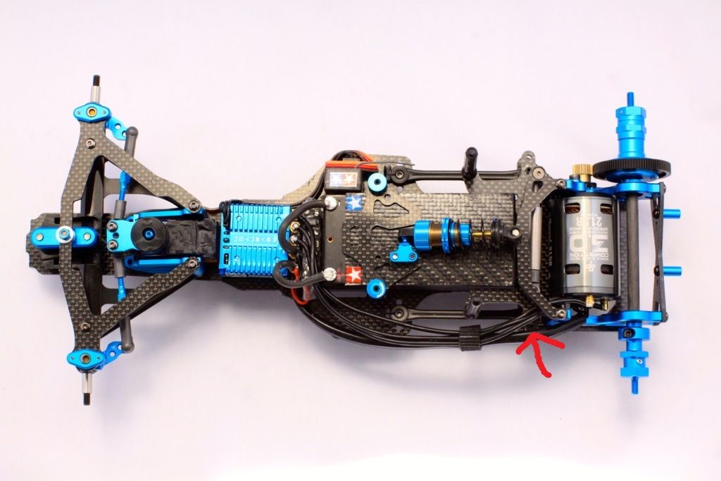

well done... i had the wires routed off the side like that also... didnt like the fact that my wires are touching the chassis. i was afraid that it might interfere with handling. but i guess thats with my 14 gauge wire.

-jacob- Well done with your build!
I was trying to get mine as clean as your but, was too impatient. I will revise mine and put my ESC closer to the motor and push the battery forward. I used gauge 12 wire, but will replace it with 14 and a Hobbywing Just Stock ESC.

I have mine mounted with the esc in front of motor ...it's a tekin rs pro anything bigger then that and it won't happen.

Yes, if you tun a faster motor you will want to use thicker wire. there is no fixed rule, but 14 gauge would handle most motor winds you could consider running in an F1.
You don't need to run thinner wire, and to be honest you won't notice the difference in handling, but to work properly you need the rear pod to move easily and smoothly. Thinner wires means they can't act as a weak spring, tweaking the rear end, and means they can flex easier so they don't fatigue with the constant movement.
