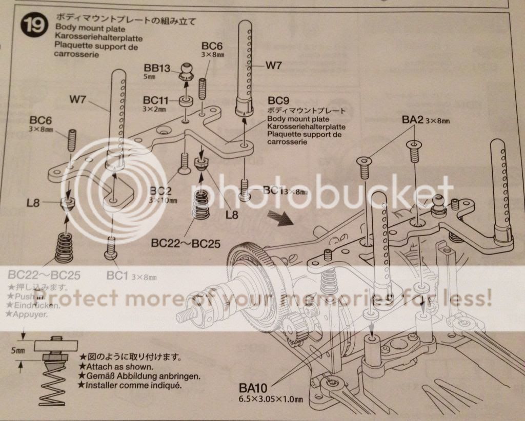

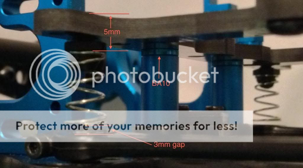

First F1 car to build so I'm a little unsure if I'm doing this right. Following the build/setup instructions my roll springs do not touch the lower brace arms.
Should I lower the screw (BC6) till the roll springs sit on the lower brace arms or should I remove the BA10 washer?

Lower the screw. The 5mm is just a suggestion.
