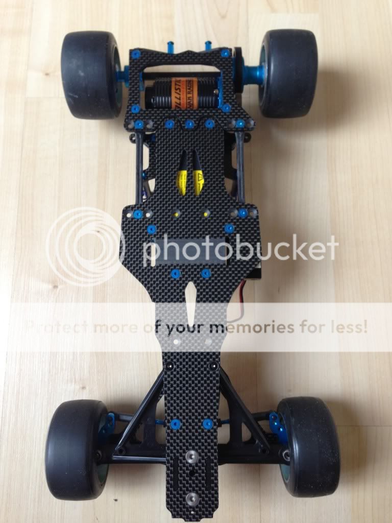

Originally Posted by PhilippineEagle View Post
Nice pictures. Can you also take one or two of the bottom of the chassis?
I can't wait to read your track impressions.
@ RTYPEC: great job documenting your build. I am somewhat less anxious to get my build now. I would rather read your posts first and get any nugget of golden information before I start my own project.
Looks like I will be investing in a good Dremel set.
here you go...

Thanks for the picture.. I was wondering if anyone would be using a diffuser on this kit. Nevertheless I am excited to know that my kit is going to arrive before the end of the this month.
