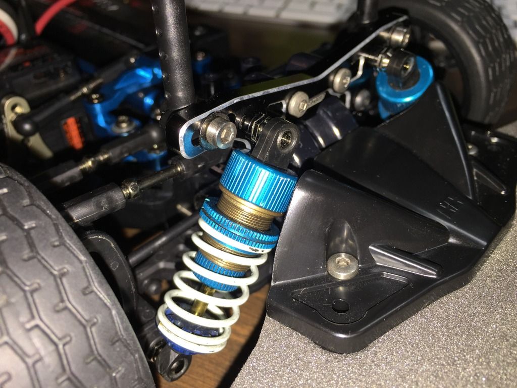

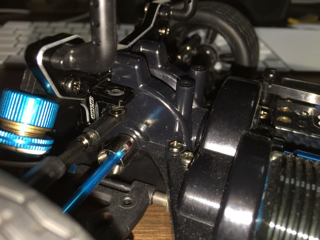

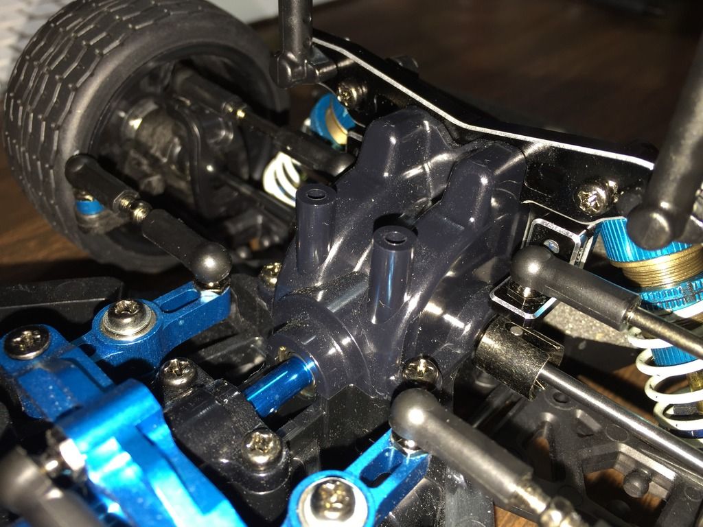

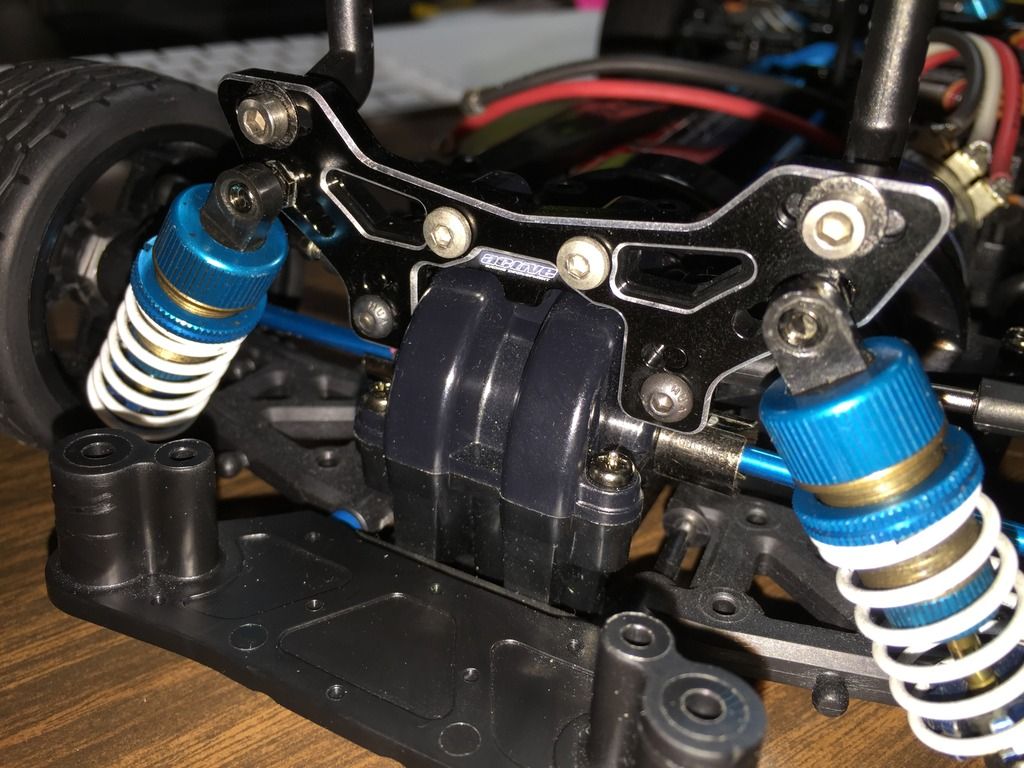

I installed the new Active aluminum front and rear shock towers for my Type-S and it sure looks nice. Replaced the fiberglass units from stock. The fit and finish is high quality, and it took out whatever flex the stock shock towers had. The body posts are now a lot stronger then before. This is my VTA runner so it is not TCS legal but I needed a VTA runner. I also emailed SPEC-R that there was a need to have sealed gear diffs for the TT-02 chassis and he replied that it is a very wise decision to have those parts available and for us to check back in about 2 months time. Can not wait.

Were you able to get a big enough pinion that you did not have to cut a hole in the pinion plastic cover? I'm running a 50T on my VTA TT02-S spec.
