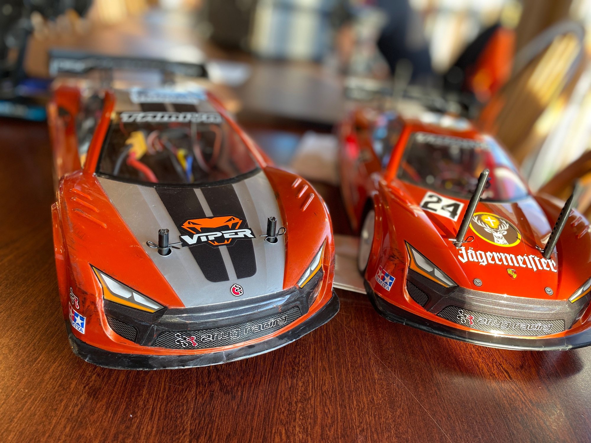

Here in Mt. Joy, PA we have an indoor asphalt track where the TT02 and TT01e are allowed to run. It's basically a box stock build. Bearings, universal joints & cups, and spec tire (USGT). Front aluminum knuckles are allowed to make it more reliable. And that's it, everything else has to be stock build. It's a FUN class because all the cars are equal.
We put sticky grease like Lucas Red & Tacky in the front diff (rear diff is empty) and some in the friction shocks to keep it from getting bouncy.
My TT02 (left) my son's TT01e (right)
