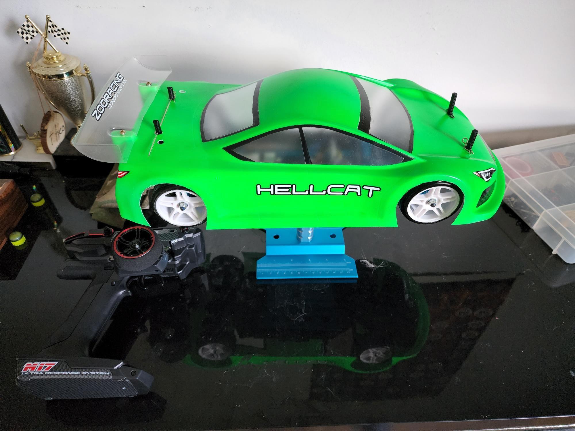

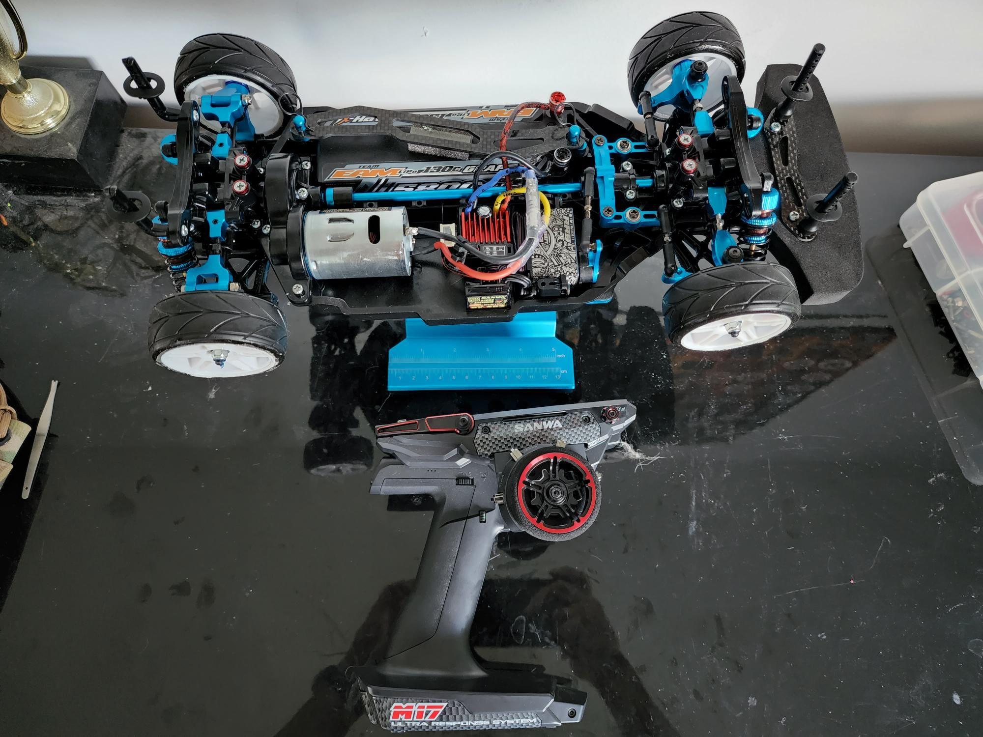

Default Setup help
Hey
I am currently setting up my tt02 for some parking lot racing. I am just getting back into it after a few years off. Please comment on my setup, any direction would be appreciated. My concern is the FDR is way off. Plus I am struggling to get no rebound in those shocks, any tips?
Sport tuned motor 64p 95t/43 FDR 5.75
Yeah 55mm shocks 500cst with 3 hole and front and rear red springs soft. from the yeah kit.
Ride height 5mm front and back
gear diffs front and rear
front diff 20k
rear diff 8k
CVD front and rear
Fully ceramic bearings cage and rollers.
hard chassis
3.0 degrees rear toe in
1.0 front toe out
Zoo racing hellcat body

Gearing: You need the yeah racing motor mount if you don’t have it. The maximum gear combo I have been able to fit in TT02 is 78T / 53T 3.83 fdr. This was with a brushless 21.5. You will need to trim the gear box cover or even cut a hole out to clear the large pinion.
Now with a sport tune however, an FDR of 3.8 will heat the brushes and launch them inside the motor lol.. I’ve experience it first hand. So you’re probably need to gear it to 4.5 fdr tops.
Springs: Try a different brand spring.. yeah racing springs rates are an unknown for racing, so hard to say what you need.

Thank you both for the insite. I did install the highspeed gear set and the Yeah motor mount I had it out this afternoon doing some practice in the school parking lot. The motor was a little warm. I changed to a 41/95 with an FDR of 6.0ish. I will try that tomorrow,
As for the shocks, I have ordered the TRF 55mm however they are on back order, I tried the TRF springs on the yeah 55mm shocks. DId not seem to work well, I could not get the right hight in check . I will try the red rear and blue front from the yeah kit. Hopefully that will correct my issues untill the tamiya shocks come in. I am having a trouble getting no rebound on the yeah shocks.
I am stuck to using the tamiya brushed motors for our club race. We run box stock silver can and chassis with bearings The mod class is bascially any add ons. However Brush motors Torque or Sport tune and the HW 1060 or Tamiya version.
SteveM I will check out your post shorty.
Is there a big difference run the TT02 with the TA05 suspension? I looking to set one up for parking lot and one for carpet.

zero rebound, you need to drill a hole
in the cap, same is needed with TRF shocks.
when you say right height, is it due to the springs being too soft? Too short? Post pictures we we can help
The TA05 style suspension that comes with the type S if allowed is much better suspension geometry. The arms are longer, better ability to adjust camber, roll centre etc. you also can opt for the down stops which will give you droop control.

Thanks for the tip on the drilling the cap. Are the TRF shocks any better than the Yeah? For my level of racing I highly doubt it.
When I used the TRF springs on the Yeah shocks I could not obtain the ride height. Standing the spring next to each other the Tamiya was a coil or two longer. When I get home I will take a picture.
I found the Yeah Red on the rear and yellow up front worked for a starting point. Using 500cst oil. Sunday I plan on doing a club racing. I will see how it goes.
So far the only issue I have had was a bent turnbuckle in the upper front adjustable arm. I was able to replace it with a Ti one from an xray t4 kit I found. Hopefully that will tighten up the front a little.

I do believe I bought the wrong spring set, thats why I was having trouble setting the ride height on the YEAH shocks.
