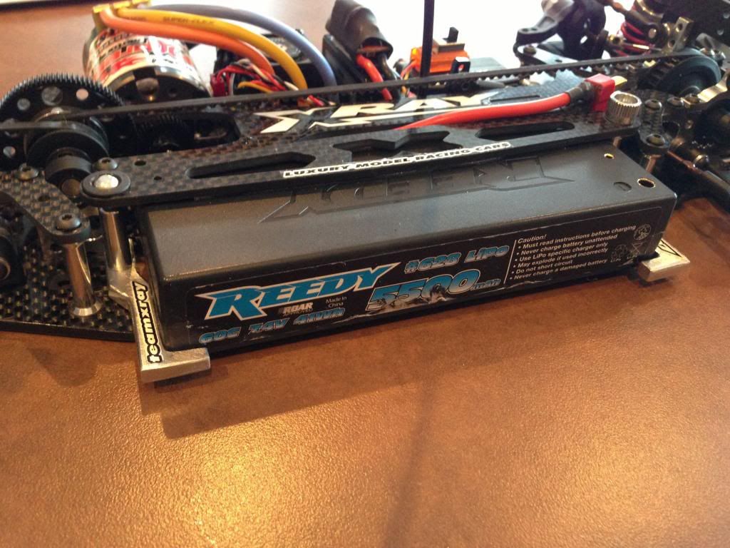

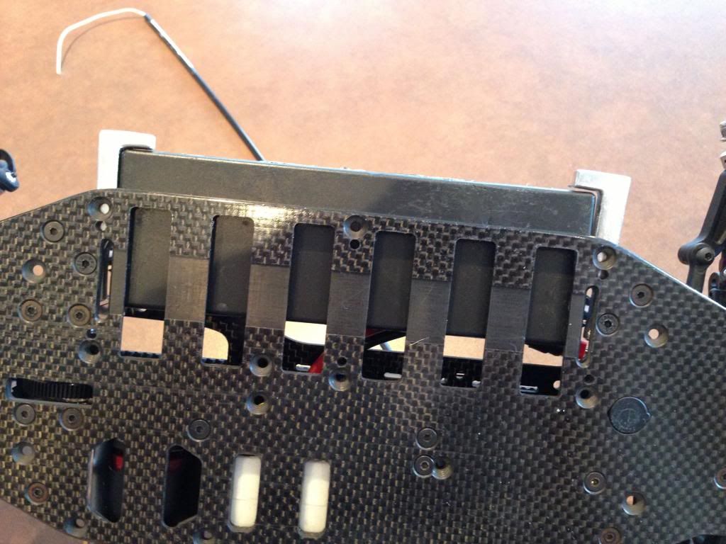

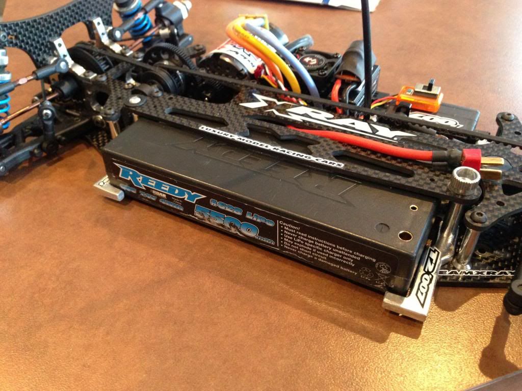

Hi Guy's
First off Happy new year to everyone.
Now, i know this is a T4 thread, but you guys seem to know your X-Rays really well.
I made a custom lipo back stops for my T2 007. The question i have is, the battery is sticking out little too much from the body. But the car is very balanced. Does it really matter for me to raise the upper deck to slide the battery in or should i just leave it like this (don't like the idea of raising the upper deck).
Also this is going to running on Rubber tires on carpet. I had it set up long time a go on foams tires. What kind of springs do you recommend for rubber?
I have not raced this in over 6 years now so any advice would be great. It will be running in 17.5 blinky.
Here some picks.
Thanks

Thanks
I wouldnt raise the top deck . But I have balanced a car or 2 by hanging the battery over the side of the car and it makes it feel lazy in the fast corners . Sweepers and suck I never had a problem but it was hard to tune the car to both types of turns with a wide layout. Think this could be one of the reasons the T4 is more consistent the small layout area keeps the weight centered and more dense than before making it more agile allowing one to tune for the entire track instead of just one or 2 areas of the track

I would raise the top deck. That's what I did with my 007. I made some rectangle and square shims out of .070 aluminium sheet. It worked great, then I added weights on the outsIde of the battery to balance the car. That's what Xray did, raised the top deck and moved everything closer to the centerline.

I currently run a T2'07 in VTA, run EAMotorsports 70c5000 packs and don't have the top plate lifted, basically same position as you. I run HUDY tape to hold the battery down tho, due to the battery plate possibly introducing tweak in a crash. I run the optional top plate without the post allowances and that seemed to make the car more responsive. Just try it and see, then take the posts off and see if you like the differance. Remember, if you raise the top plate you will be lifting the top bearing up off the steering rack
I put a c clip big enough under each steering bearing holder ( top deck and chassis) to keep the steering post secured. It worked great for me but it may be easier to buy a low profile battery. The only drawback is that you would have to add more weight to the size of the battery.

Thank's guys.
I know i de-railed the thread a little but really appreciate the help. I will run it like this and see how it goes. If i don't like the way it handles i will raise the top deck.
Yellow and white springs. Got it.
