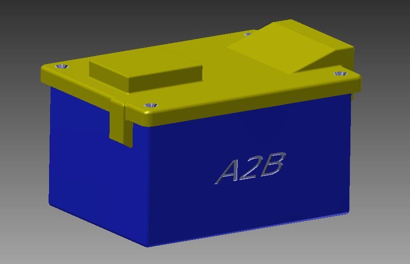

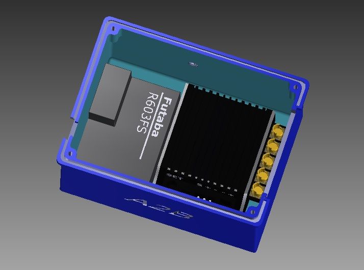

I have been thinking to buy the carbon damper stays of the R1, that should solve any problem with the dampers/springs on my S2 chassis.
Been thinking to buy the upper deck of the R1 version too, this should improve the flex of the chassis and it will give me more space on de lower deck to mount a waterproof box for my electronics.
Here is an example of what i have been drawing so far.
