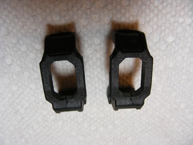

Default Check your C-Hubs!
Screw fell out of the bottom of my RF Steering Block. Turns out the screw fell out because the back side of the bottom of the steering block was missing.
Put it back together and something felt wonky. Took the C-Block/Hub out and inspected it carefully and found a hairline crack. It was still holding everything together and the crack was almost invisible.
So then I take my LF suspension apart and sure enough, that C-Block was cracked. Lord knows how long I've been driving on it this way.
Long story even longer..., so then I take my second (VTA) S1 apart, and you guessed it, another cracked C-Block!
Point being, apparently they crack easily and they don't necessarily fail catastrophically.
I'm going to blame these for all of my bad driving of late...

Can you take a picture of where yours are cracking?

Both of these are cracked at the 6 o'clock position and then going to the outside.
Both are cracked all the way through, but still hold everything together well enough to not be readily apparent. Keep in mind, I had to clean grease and carpet fuzz off of these.

If you are using the aluminum ball studs check those to. They are pretty soft and I found all of mine bent that was throwing my car off. Havn't seen any cracks anywhere.

have you shimmed away the sloop in the c hubs? i did a tc6 mod to mine, schim to stop back/forth play + ca glue on the hingepin because of the hole being a tad to large, that might help a little by stoping it from moving so much.. mine had ALOT of sloop out of the box.
strange way to break a c hub, will look at mine a little closer during the winter for sure
